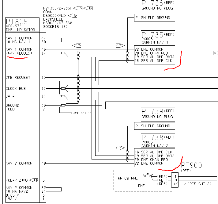

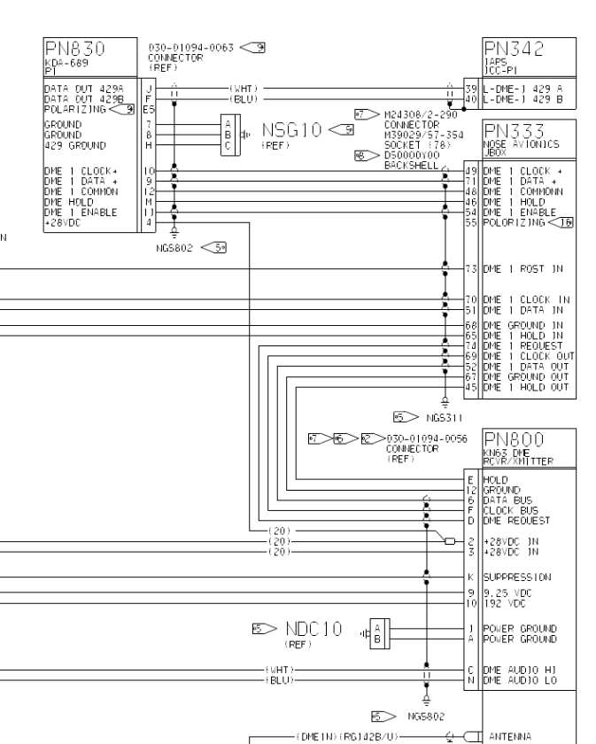

And I also attached wiring diagrams....

From your prints, the DME indicators feed the Garmin displays.

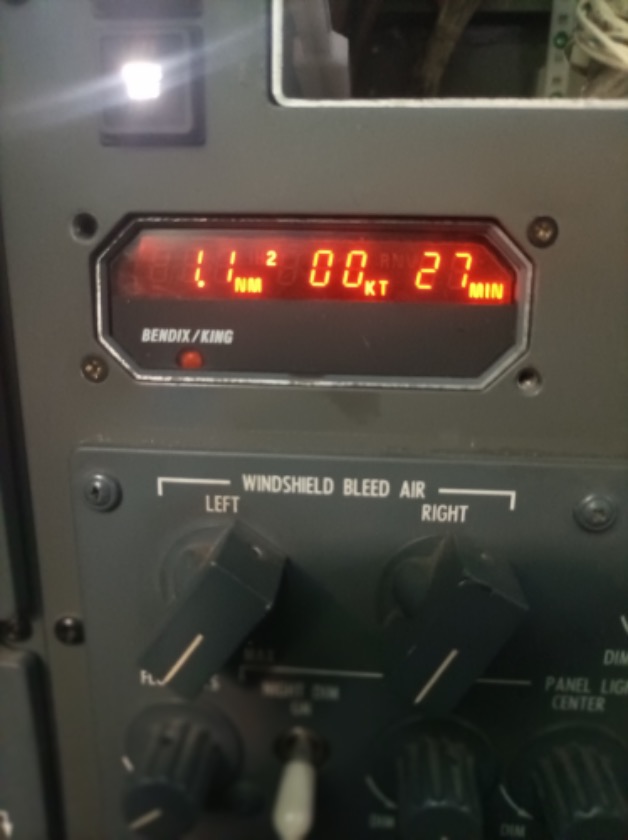

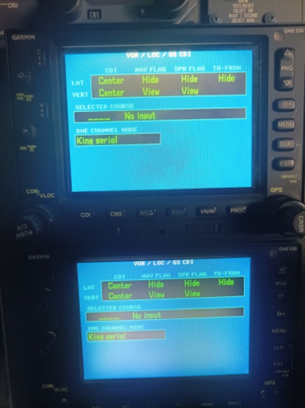

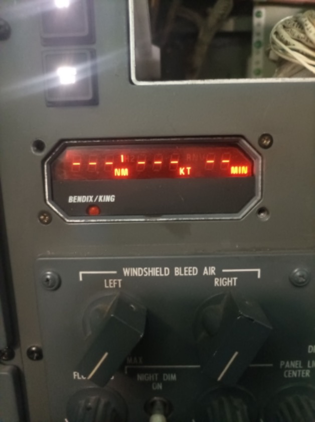

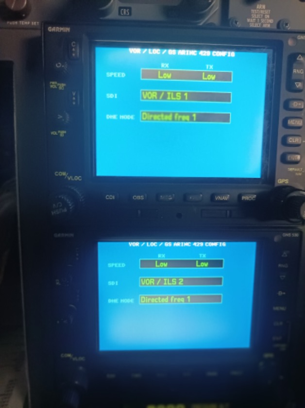

Sir there is only one DME tuned by two GNS 530 for selection NAV1 and NAV 2 there is sperate switch For indication  both PFD  and Bendix king indicator KDI 574  So first we tune DME   by No.1 GNS 530 there is  No distance and no audio tune heard Sometimes I noticed there is audio tone and no distance on KDI 574 And next step we tune DME by no.2 GNS530 there is distance on both PFD  and Bendix king indicator KDI 574  And audio tune heard  Next step now we Swap GNS 530 with each otherNow swap conditions And next step we tune DME by no.1 GNS530 there is distance on both PFD  and Bendix king indicator KDI 574  And audio tune heard  And we tune DME   by No.2 GNS 530 there is  No distance and no audio tune heard   But after 3/4 power cycle  DME Not showing distance and no audio tone by both GNS 530  Sometimes it show  distance on 1 and 2 selection by GNS 530  But sometimes not This system is only one of our aircraft not in any other so we can’t swap anything from. Another aircraft I don’t understand what to take next step now

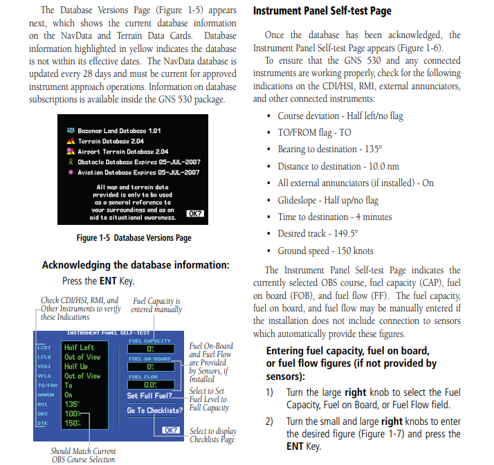

I downloaded and viewed a couple items from the GNS530 Pilots Guide.
Page 16 shows a power-up self test page which states that if you see a distance of 10.0 NM, the DME input to the system is functioning. Do you get this on both control heads?

But after 10 minute  on DME by Nav 2 its show no distance on KDI 574 and Both PFD

Now we swap GNS with each other

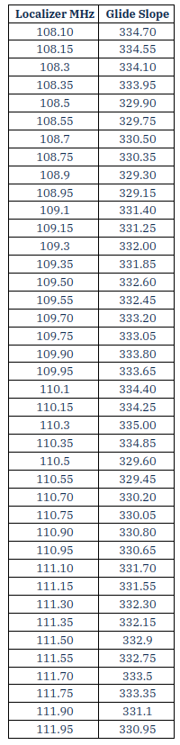

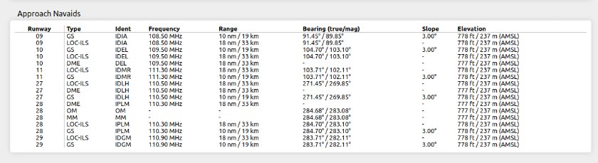

Here's a list of active ILS's
2 years 6 months ago #1445 by Emblemdhc

now we have doubt on GNS 530 its may be  misbehaving

Two ILS's with DME.
It seems odd that certain frequencies work, but others don't. Verify the tuning wires from GNS-500 to the DME are all there. The data wires are also suspect. I'm also not sure what the KDA-689 function is. It's titled as a ARINC Serial Adapter. It sounds somewhat suspect....

2 years 6 months ago #1447 by Mark
Look at these three wires....

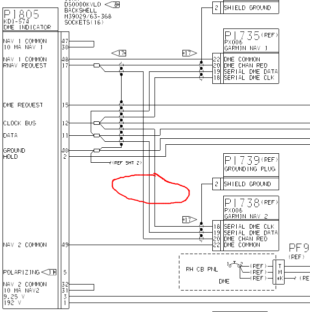

2 years 6 months ago #1448 by Mark
The upper right section of this print only shows one 429 Data Bus coming from the left GNS.
Is there one for the right? It might not even be setup to use the right.
