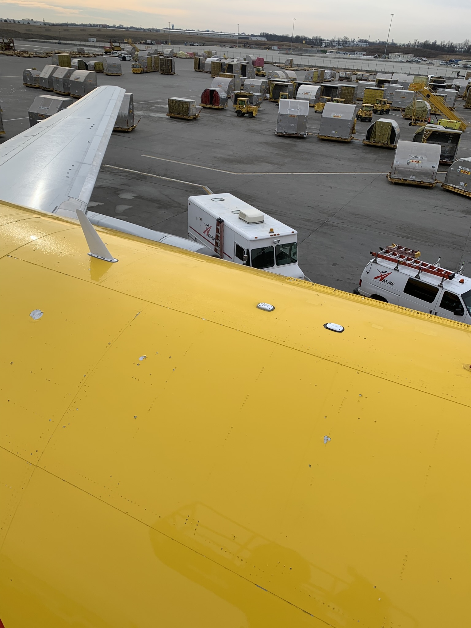

Right GPS not able to receive satellite information. On this aircraft the right antenna is forward mounted.
GPS Antenna Locations
   Ready to change.
Kalitta/DHL hangar going up in the background.
Hangar

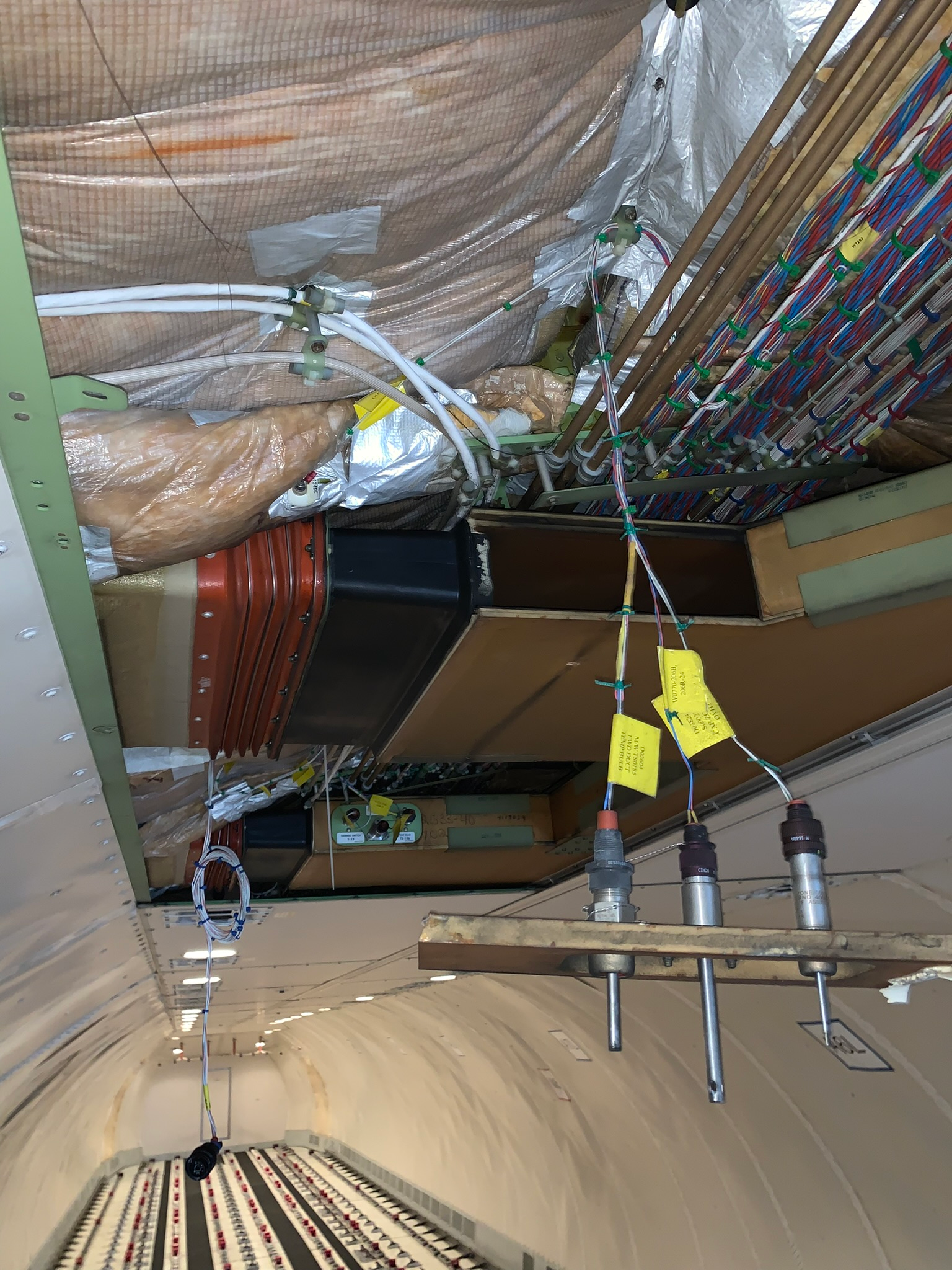

Duct Temp Sensors
Wouldn't it be best if the sensors were actually "in" the duct?
DuctTempSensors
The crap I'm finding on a weekly basis is disheartening to say the least!
Duct broken, sensors laying on ceiling light.
Heat from light caused a "Duct Overtemp" warning from tripping the high temp bulb.

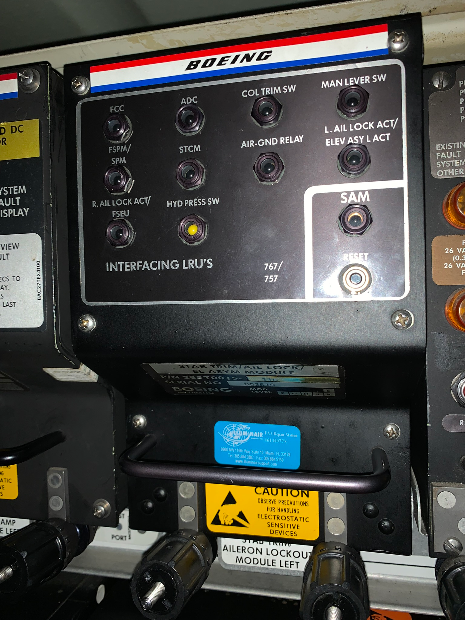

Pressure Switch fault ball showing on inbound "Stabilizer Trim" EICAS message.
S27-2
What is the fault ball saying?
The Stabilizer Trim/Aileron Lockout boxes verify they have two viable hydraulic systems (in this case left and center), by comparing on-side to off-side pressure switch signals. This is the left box, so it looks at the left pressure as on-side and center as off-side.
The right box would look at the center hydraulic system as on-side and the left as off-side.
Either way...... there's a mismatch. The meter confirmed this to be true. With hydraulic pressure applied to left and center, only one (of two) input pins showed a ground (both should have).
The left pressure switch was at fault.
We shot the switch by pinning directly into it. No issues.
We verified wiring..... Pin 3 was showing a hard ground. Pin 2 wasn't.
No frickin way. Sure as shit, pins 2 & 3 where swapped in the plug.
This pressure switch feeds numerous other units which are looking for the same ground signals. All six spoiler boxes, the yaw dampers, and rudder load limiters.
It also plays a roll in automatic functions of the hydro pumps and the overhead low pressure lights.
How in the ---- wasn't there some other issues with the aircraft???
Too tired to follow them all out. Either way, after the wiring was corrected, all systems (that we knew of) checked out.
Correct wiring verified by wire numbers.....
S27-1
  ..... and continuity checks from the P37 panel.
S27-3
S27-4
With the pins in wrong positions, with no pressure - the grounds were correct. With pressure, both pins on the unit had continuity to each other. I really just don't know how anything worked right!

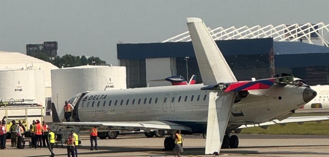

When the wing of a larger aircraft (A330) smacks the tail of a smaller one. They both lose..... one though, hurts worse.
Not sure if this is repairable.

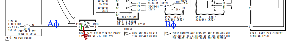

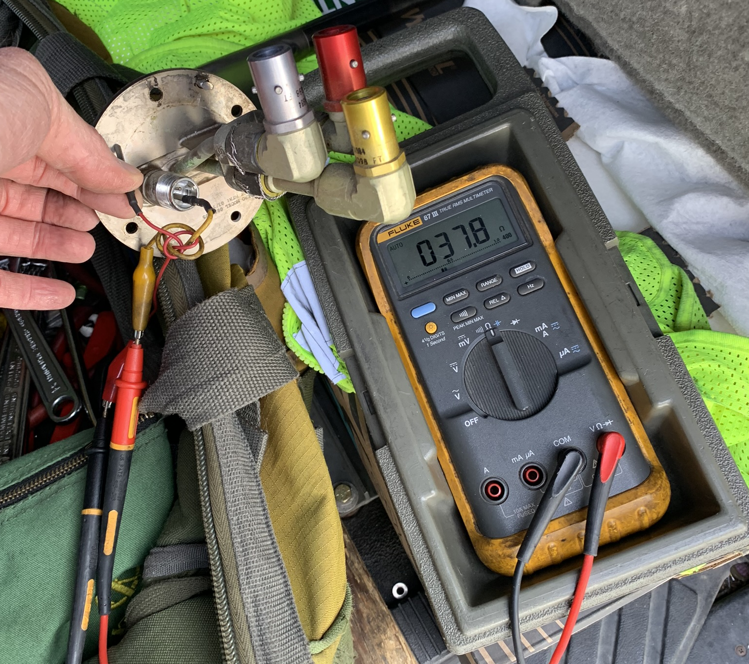

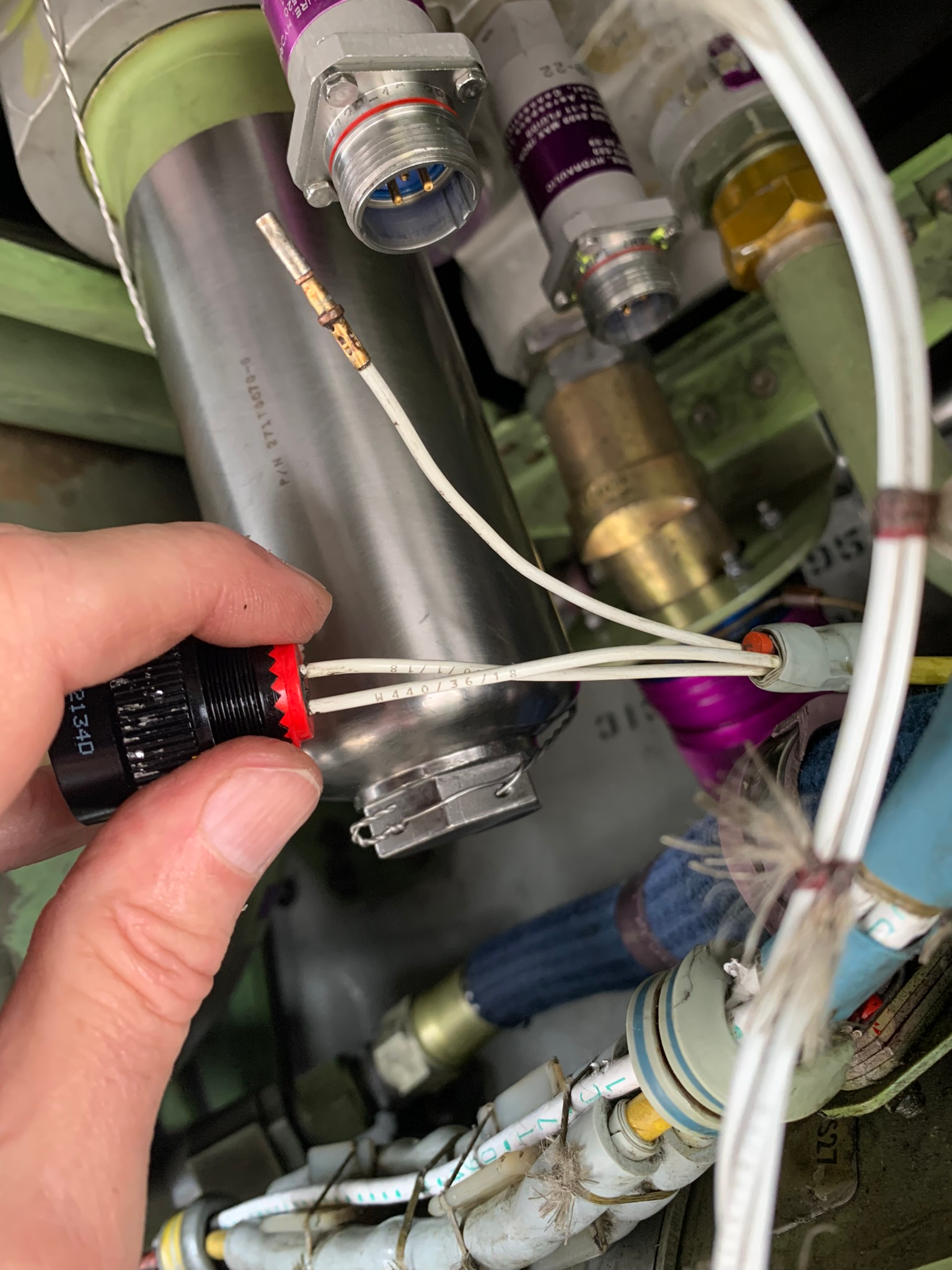

Captain's pitot heat fail light on after engine start.
pitot2_091224
Please reference https://rotate.aero/forum/767-ice30/242-ata-30-31-pitot-heat for an understanding of the 767's pitot heat system.
The system has two heat modes, low heat after engine start and high heat in air mode.
This particular problem (failed Capt's Pitot Heat) showed up after engine start.
Pitot heat test from the P61 panel was normal.
I took out the Current Sense relay (K241) and shot the probe coil from "Pin C1". 38 Ohms..... seems normal?? Pulled the "A Phase" breaker..... still had continuity..... not normal.
What the hell is going on here?
90% of pitot heat failures are heater coils burning open. This one tested from the cockpit test switch, so the coil is still good.
Well kinda..... In test mode, you're simulating "air" mode or high heat. "A" and "B" phases are connected through the heater coil in air mode, instead of "A" phase to ground in "low heat" mode.
We pulled the probe and shot it with VOM. We found out one side of the coil wire was shorted to ground and the other completely open.
That would explain our problem. In low mode, "A" phase was going nowhere (open leg on coil), In high heat mode, "B" phase was coming in from the opposite side, going through the coil to ground. It was enough current to turn off the fail light. The pitot probe would of been heated in the air, but only in low heat mode.
I have never seen a probe fail in such a manner.
pitot1_091024
Red represents short to ground. Green, the open pin.
I wish I could show the whole circuit, but Boeing has been watching the site for plagiarism.

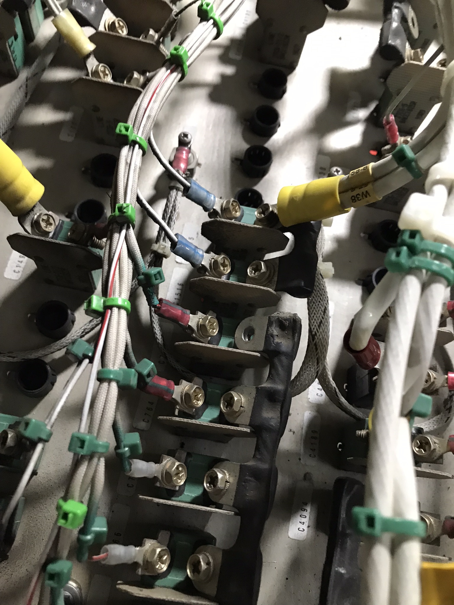

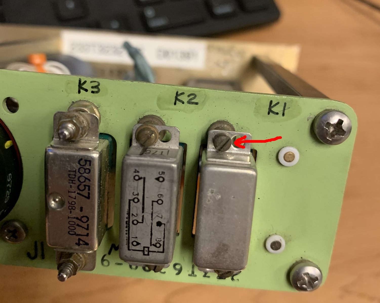

Doing a wiring modification. Some of the cockpit overhead breaker panels down. What do I see?
breaker2 081424
Missing screw on bus-bar. Not good.
System involved..... Fire detection left engine alternate power.
This would not be seen by the crew or maintenance when doing fire system tests as it is not the primary source of power. If you were in an emergency on Standby Power, fire warning would not work
