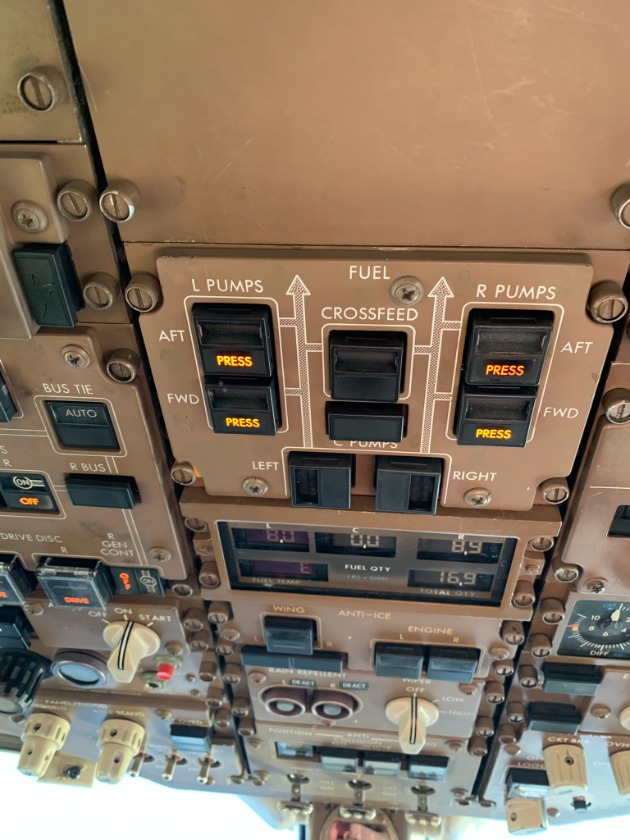

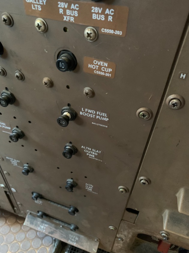

The only way to know if the DC Pump is operational is to fail (pull the circuit breaker for) the left forward AC pump when the APU is running.
This will cause the left forward "Press" light to come on and a EICAS ECS/MSG of DC Fuel Pump.

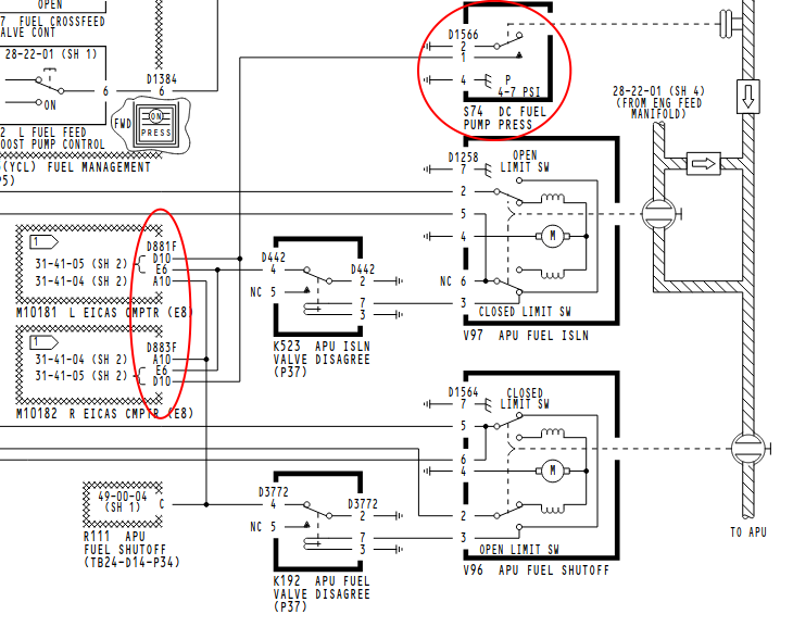

The message is pressure switch (providing a ground signal to the EICAS computers) derived.
If the pump was not working, the message would not be displayed.
The three pins feeding the EICAS computers for APU fuel feed are....
F-A10  APU Fuel Valve (if the valve is not in the commanded position)
F-E6   APU Isolation Valve (if the valve is not in the commanded position)
F-D10  DC Fuel Pump On
