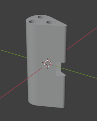

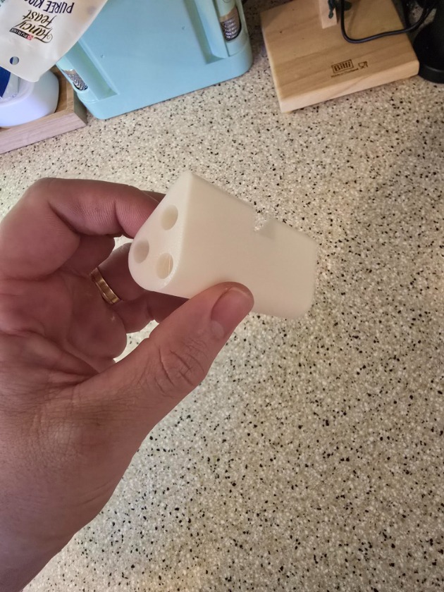

Was getting sick of digging through the bag of pins in the door for the gear pins, so I created a 3d print model of a gear pin holder to make them easier to find. Made like the ones that come on the 650 not sure if this originally came with the aircraft and was lost or they never had one. Either way this fits the pins quite well, will have to see how it holds after time may need to change material after all the hot and cold cycles.
Printed : PLA
Print Time : 1:45
Print Cost : .25

Using Flashprint to print the file. Initially tried uploading to flashprint. Then noticed the insanely small size. Also, when I sized up the model to 4 inches, the holes became unnattached and not the best file. Do not beleive it is the printer. What should the dimensions of this be?

Much better! However, it comes out to being 84 inches tall. What dimensions should this drawing be when printed? It has some weird lines/cuts in it, but I can try to CAD those out.

It should be 85MM the size is roughly 25.84x40.00x85. I made it all in mm.

I think I see your issue, when I open the file in blender and Creality the model is sharp, I opened it in meshmixer and I see the odd lines and fragmented faces. I think it just comes down to the boolean operations destroying the faces. Let me know if your not able to get it to turn out I will re create it in Autodesk tomorrow.
