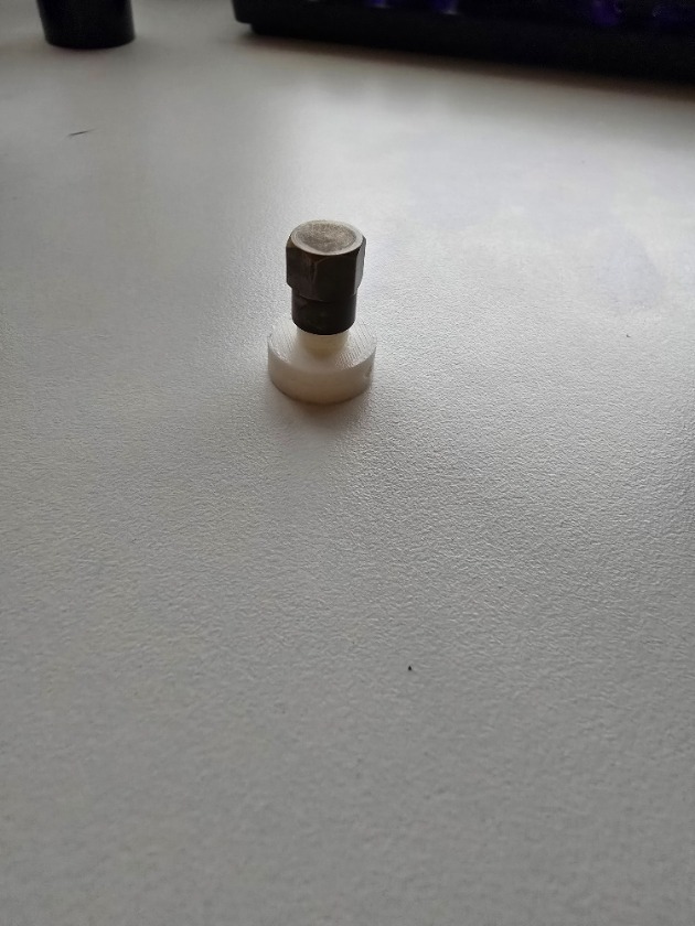

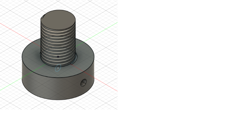

I made a super simple but helpful little tool, especially for those of us who are under repair stations facing audits. We had a finding twice of nitrogen servicing cart ports not being dust protected we were originally just using plastic bags which seem to always tear or disappear. So just a small cap with a hole to safety wire to your house or cart. Make sure to print as 100% infill, I made the first batch with 20% and they did not last.
Printed : PLA
Print Time : 00:14
Print Cost : .04
STL FILE DOWNLOAD

That's a better idea than the bags. The use of bags on oxygen cart fittings just leads to dirt, grease, and moisture exposure.
1 year 8 months ago #1673 by OG GarlicSalt
Easier for sure, also Mark this will not fit on oxygen cart though this is sized for nitrogen service fittings for tires.
