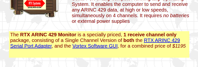

The one I use is below (cheapest I could find). Single channel - receive only.
They provide the serial adapter and software with the product.
www.rtxsystems.com/Products.html
The info below is for their TX/RX model:
www.rtxsystems.com/SPA.html?gad_source=5...4EAAYASAAEgJGXvD_BwE
The RTX Serial Port Adapter (RTX SPA429) is a family of compact ARINC 429 devices that plugs into a serial port (or a USB port with an adapter) of any computer, running any operating system, and enables the user to access up to 4 ARINC 429 channels easily and inexpensively. The standard RTX SPA429 can transmit on 2 ARINC channels and receive from 2 ARINC channels in either high speed (100 Kbps) or low speed (12.5 Kbps) data rates (or both simultaneously). The RTX SPA429 can process all 4 channels at full data rates. There are no restrictions on the number of labels that can be transmitted or received. There are no batteries to replace or charge and no power cords to hook up (the SPA gets all of its power from the RS232 port). No installation or setup is required; no device drivers are necessary. Just plug it in to a RS232 serial port (or a USB port with a standard USB/RS232 adapter) and run your (or our) application software. Its not even necessary to power down the computer to install the RTX SPA429. Any program, written in any language, for any computer running any operating system can transmit and receive ARINC 429 data as long as the program can send and receive data to/from the serial port. If you're writing your own software, a Windows API is included to make programming simple. When used with your software, or with our  VORTEX Windows GUI , the RTX SPA429 can be the heart of a powerful and sophisticated ARINC 429 system that is versatile, portable, inexpensive, and easy to use.
