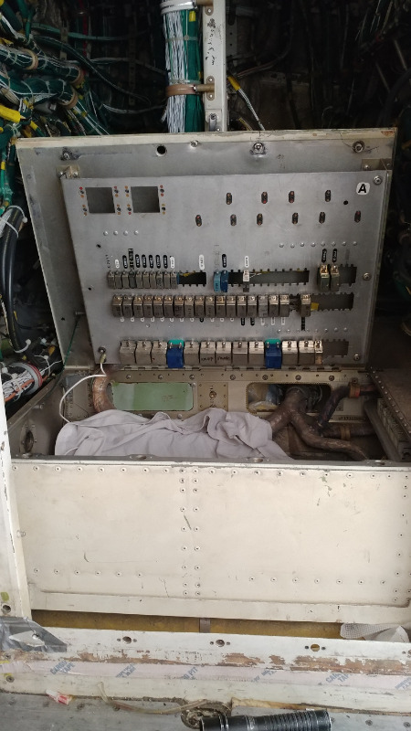

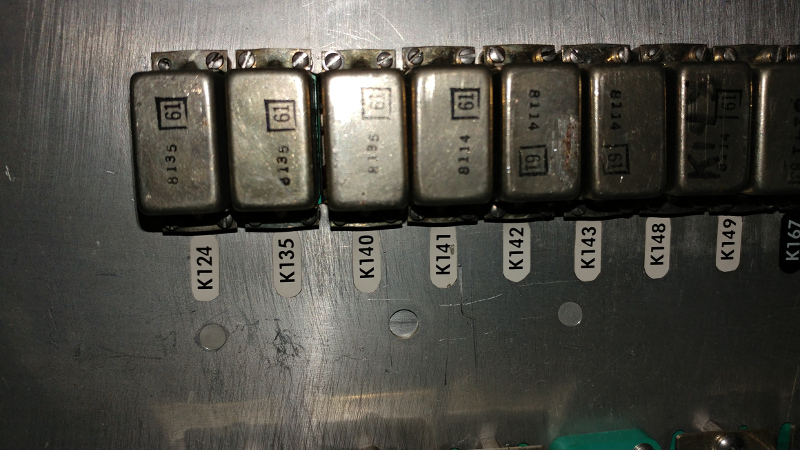

Thinking this was a air/ground issue, I located K135 in the P36 panel. This relay tells the card if the aircraft is airborne or not. This relay, along with about twenty others is ultimately controlled by the nose gear squat system.
P36, forward pit, forward right side.
K135, tiny-ass relay with even tinier screws.
A relay swap did not help the issue. This pretty much ruled out the air/ground system and this topic was moved from chapter 32 to 31.

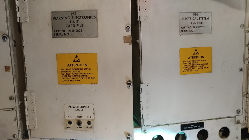

The module card is located in the P51 panel (E/E right wall).

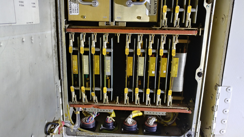

We pulled the card (3rd from left on the bottom), nothing obvious was seen.
After reinstalling it, we ran up and put the aircraft in take-off configuation. All faults went away except the flaps. 5 degree or 10 degree flaps did not make a difference.
The flap warning could be be a secondary issue, but the original problem remains. If any item is out of configuration (brakes on for example), this warning continues to flash. This certainly is not normal and quite a nuisance when sitting in cockpit while on the ground.
This post will be updated after a replacement card is tried out.
Last edit: 8 years 6 months ago by Mark.
8 years 5 months ago #500 by Mark
The replacement card did correct problem.
