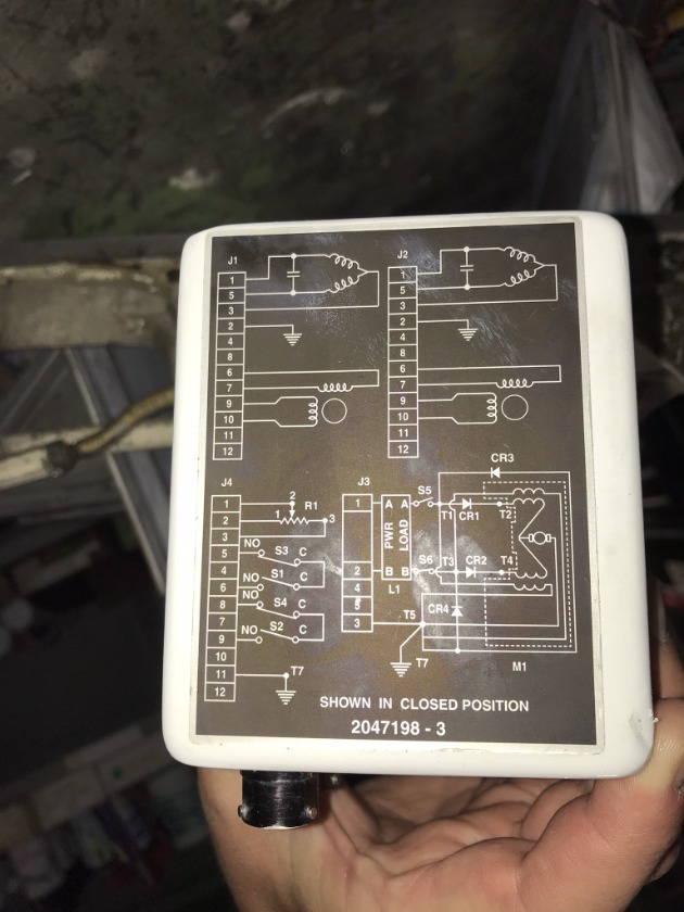

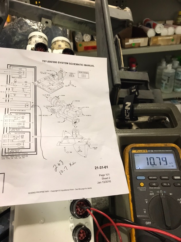

The resistance of the position potentiometer inside the valve is approx... 10.7K ohms.
And could be easily substituted with a 10K ohm potentiometer like the one below for troubleshooting purposes.
