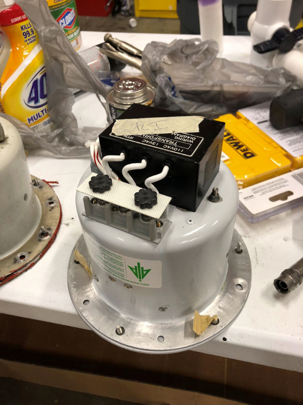

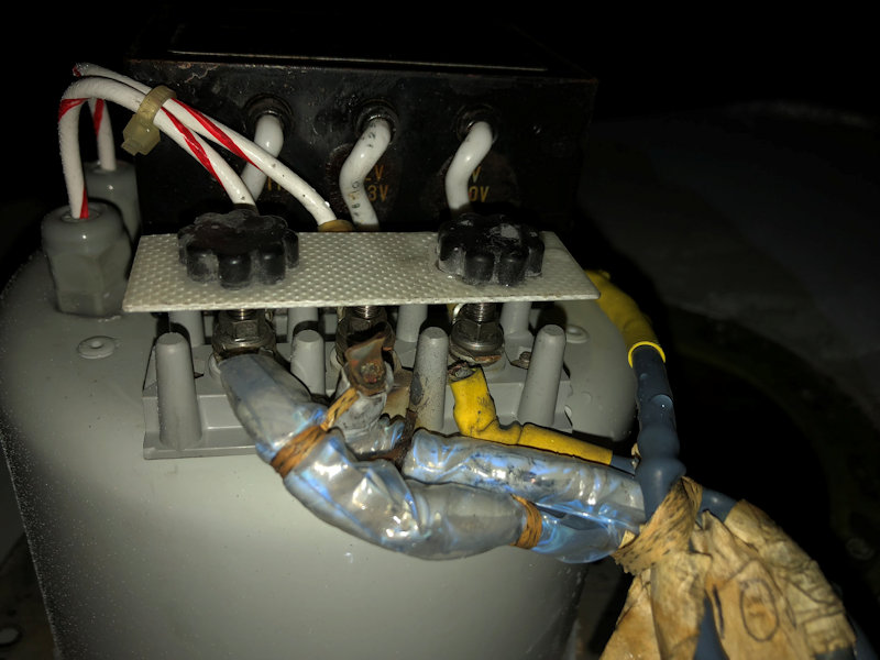

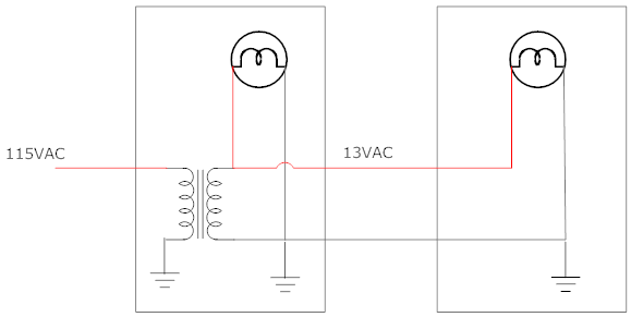

There are two logo lights installed on each side of the horizontal stabilizer. The inner light has a step-down transformer incorporated in the assembly. This transformer takes the 115VAC input down to 13VAC which is used by the lights themselves.
The outer light is wired across to the inner assembly's transformer for its 13VAC power.

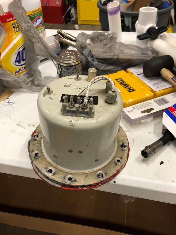

Both lights will be inop if you pull the inner assembly and see "this".
