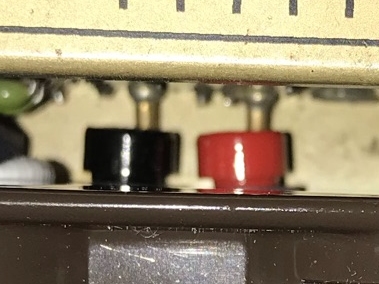

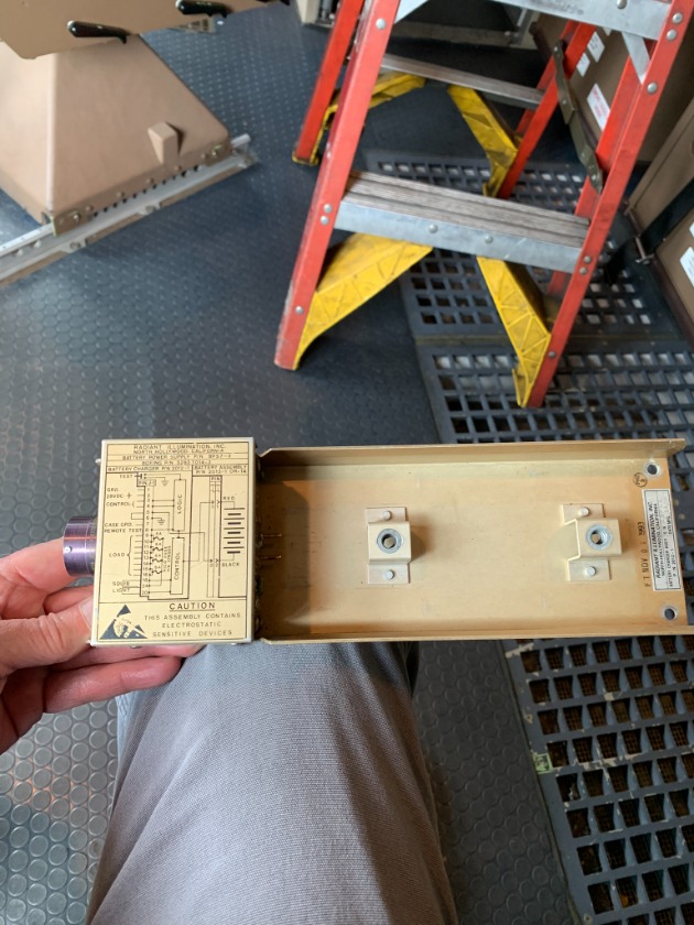

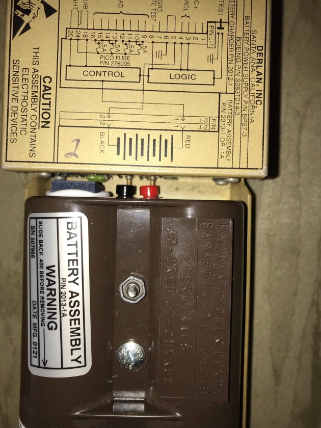

Aircraft just out of "C" check. A couple emergency lights inop.....
Dropped the overhead battery storage panel and just stared for a second.
Is that what I think it is????
The pins from the charger are supposed to go "in" the sockets on the battery...... not underneath them.
I'm not quite sure how the battery was even installed this way.
5 years 2 months ago #767 by Clipper
Replied by Clipper on topic Emergency Lights
Wrong , but rather close looking battery was installed? Or were the pins bent as a result?
5 years 2 months ago #768 by Mark
Replied by Mark on topic Emergency Lights
Bent down...... They had to be carefully straightened out (with power removed from charger).

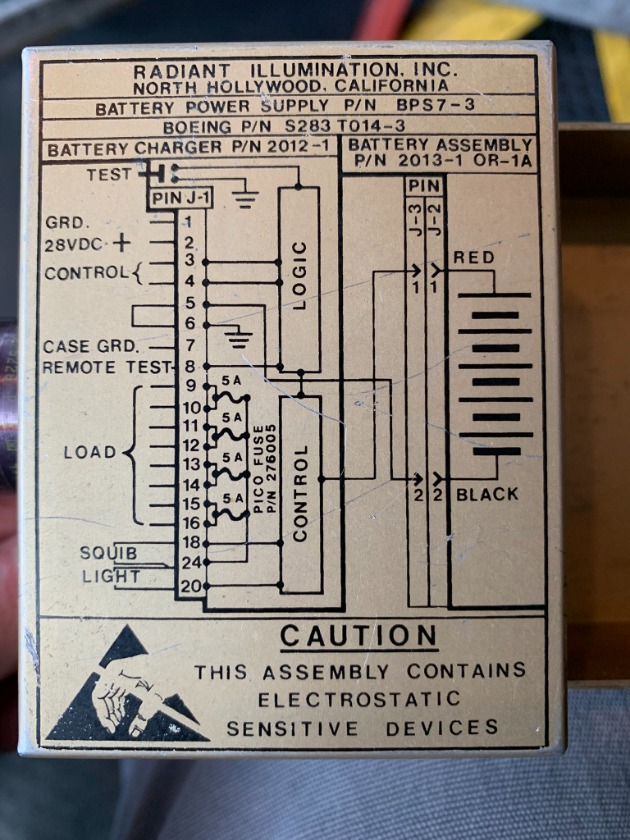

 Assembly and Part Number
1 year 6 months ago #1709 by OG GarlicSalt
Replied by OG GarlicSalt on topic Emergency Lights
Also if you see the fuses on the charger diagram, they are readily available for order easy to replace on the side and 9/10 times when a charger is failed that's the culprit.
1 year 6 months ago - 1 year 6 months ago #1710 by Mark
Little 5 amp ones if I remember correctly.
Update: Uh.... it states fuse amperage right there in the image.
