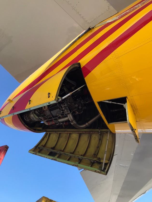

A recently replaced (supposedly overhauled APU) would not accelerate above 30%. Between days On/Off and shift changes, this APU had 50+ attempted starts over 4 days. EGT temps during start are around 750C. This drops quickly to around 350C-400C after a completed start. All of our starts failed. The faulty APU went from 750C to ambient every failed start. This type of thermal shock is not conducive to long term service of the unit.

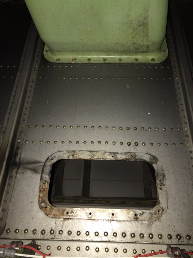

We faked the inlet door open signal. We eliminated an air input issue by removing an inspection plate at the APU plenum forward of the firewall and tried a start.

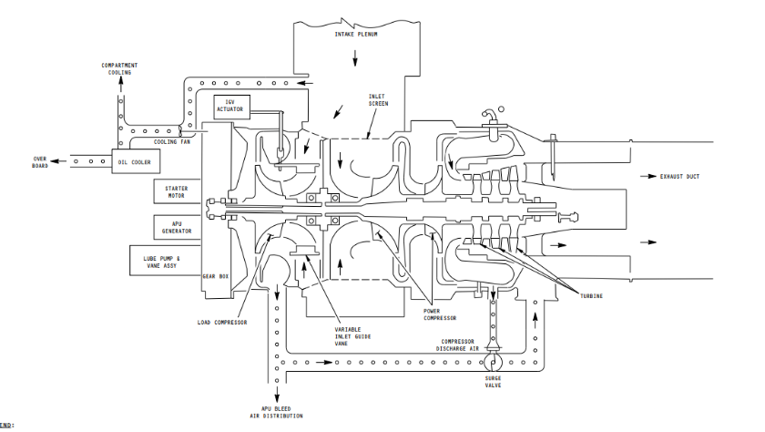

We verified the IGV Actuator operation by pulling it out before start. (It should close during start as soon as fuel pressure from MEC is available.) Shown in video below.

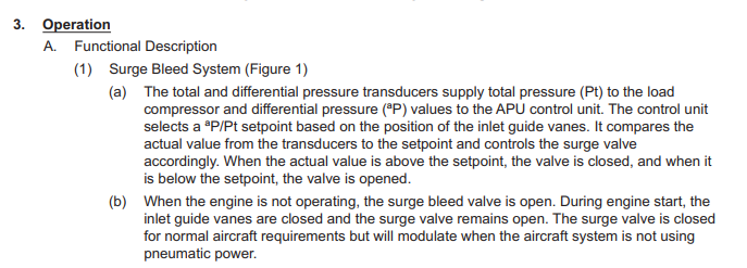

We also verified the Surge Valve was remaining open though-out the entire start. (I initially thought it should close, keeping all air for starting - I was wrong.)
The Surge Valve should remain open. This relieves all compressor loads during start.
