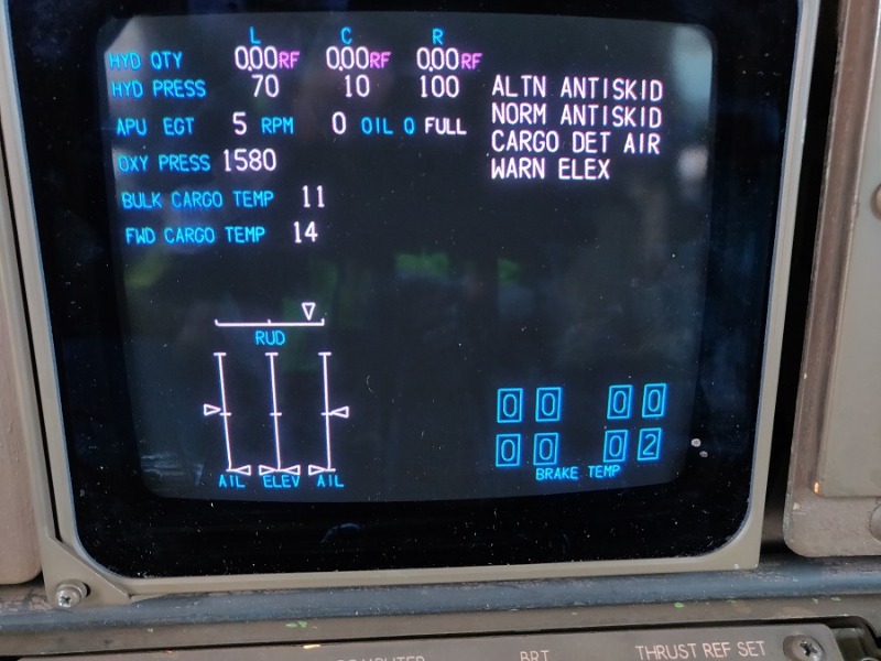

Previous to that though, I simulated brake temperature signals from the monitor unit to the EICAS system.

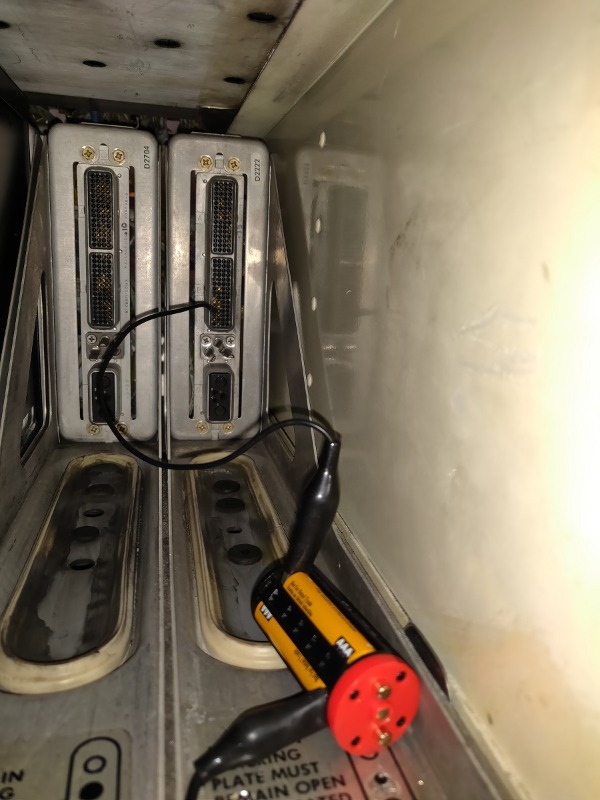

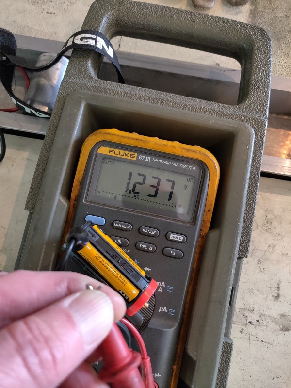

I used a flashlight battery pack that had an output of about 1.2VDC.
I fed this voltage into pins C10, C11, C12, C13, D9, D10, D11, and D12 of plug B at the monitor rack. The negative lead from the battery pack was connected to aircraft ground.
With a 1.2VDC input, each brake indicated 2 on the EICAS system.
