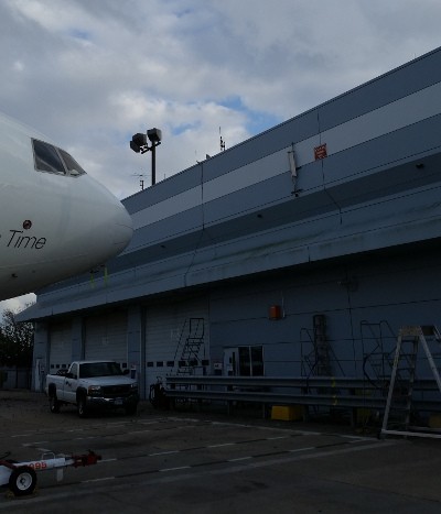

T-KIAH6 Radar Feed to Flightradar24
N29.9768 W95.3441

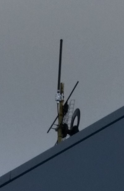

Removed old analog TV antenna and placed ADS-B antenna on top of pole. (Digital TV antenna located directly below.)
Cable run to MX office feeding ASUS micro computer with GNS5890 USB dongle receiver.
Because FedEx blocks most, if not all ports, I had to purchase a mobile hotspot for the feed. T-Mobile (which usually sucks almost everywhere you go) has a tower near terminal "C" here at the airport. Getting about 10Mb up and down for speed.
I think FR24 prefers their supplied receivers (designated by an "F" instead of a "T") over receivers supplied by individuals, but I seem to have quite a few non-airport hits also.
I've got the airport covered. My receiver's range is about 200 nautical miles maximum, with 100 being nominal.
I've seen T-KIAH5 covering the north side of the airport at times. I think this is someone who feeds during work hours only.
When I follow an aircraft through takeoff, I see either Galveston, David Wayne Hooks, or College Station snatch it from me around 2K altitude. And somebody with the receiver T-KAAP must have a damn good setup also. I have had aircraft stay with T-KIAH6 out into the gulf and up to around Cleveland, Texas before they drop me.
