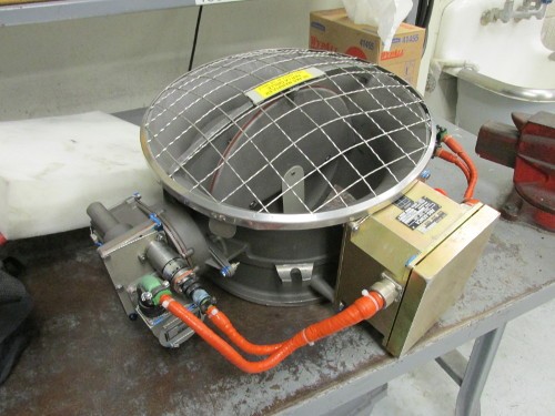

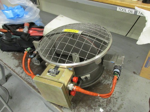

These two pics are a BFS outflow vale that failed to drive in the manual mode.
Without digging into it (and I could be wrong) this side of the valve has the (DC) manual mode motor and the position transmitter.
This side has two plugs going into a motor assembly of some type. I'm guessing there are actually two motors that are used for automatic operation.
