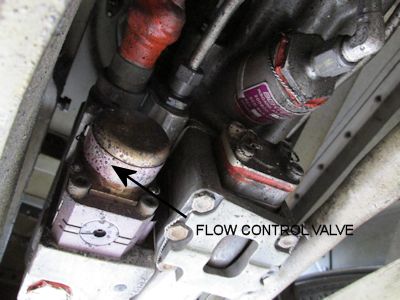

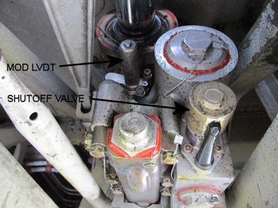

Removed the #2 FCC and shot all associated coils of the right-hand inboard aileron actuator. The actuator has one MOD LVDT(4 coils to be shot), one RAM LVDT(four coils), one SHUTOFF VALVE (two coils, but only one reading), and one FLOW CONTROL VALVE (two coils, one reading).
All coil values are called out in the Fault Isolation Manual. One point to be made is the excitation coils for the two LVDT's which are in parallel. The FIM asks for pins to be removed from a terminal block in the E&E to isolate them. That is NOT needed. There are two plugs on the actuator. P1 has the RAM LVDT wired through it. P2 has the MOD LVDT. Pop one plug off do a reading, put that on and pop the other plug off for the second LVDT coil to be read.
For this problem, the SHUTOFF VALVE coil was reading high. When P2 was removed it had pretty bad moisture. It could of been water, de-ice, or hydraulic..... either way, a cleaning and re-seat did the trick. The actuator engaged and operated correctly.
As a note, all components except the RAM LVDT are replaceable. P2 is located by the FLOW CONTROL VALVE. P1 at the rear of the actuator.

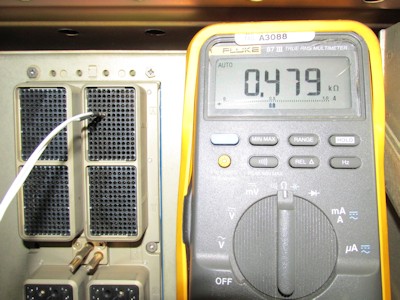

Proper shutoff valve reading.

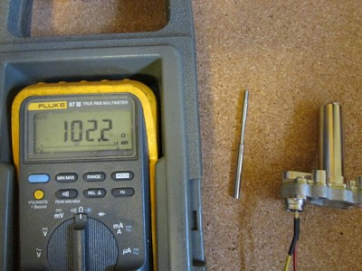

Control valve.

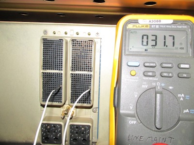

MOD LVDT pins A&B excitation coil: pins P&R of P2 on actuator which are easier to shoot from E&E.
