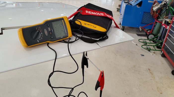

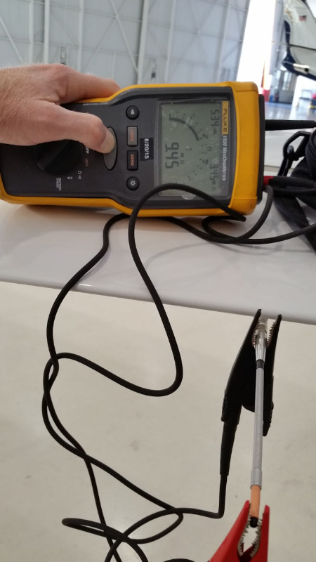

Aircraft have timed interval checks on all the installed static wicks. This check usually verifies two items. First is the resistance of the wick itself. This reading is taken from the base to the tip. This particular Cessna asked for a reading between 6 to 200 Meg Ohms. The second check is to make sure the wick base has good bonding to the structure it is mounted to. This reading is taken in milli-ohms. Poor bonding basically renders the wick useless.
Both the meg-checks and the milli-ohm resistance checks can be accomplished with one of the newer type Meg-Ohm meters out there. An explanation of the meter itself can be found here. ("Zeroing" out the test leads for a milli-ohm check should be accomplished often during a complete aircraft wick base bonding check.)
