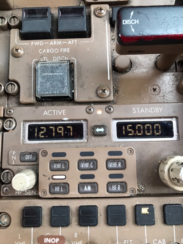

Frequency selection is accomplished from a panel in the cockpit.

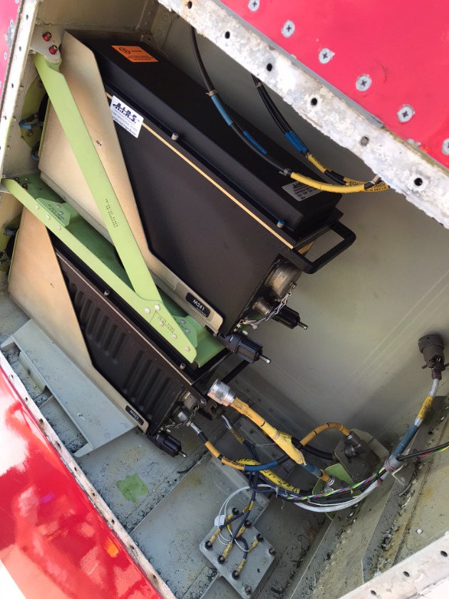

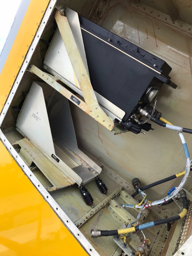

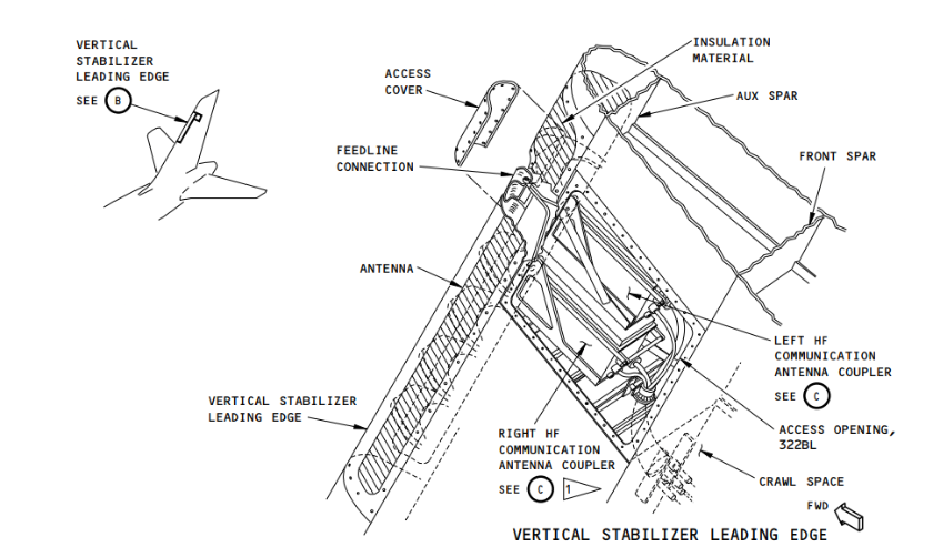

The RT (Receiver Transmitter) is located (on a 767) in the main equipment center. There is a tuning device called a coupler located inside the vertical stabilizer.

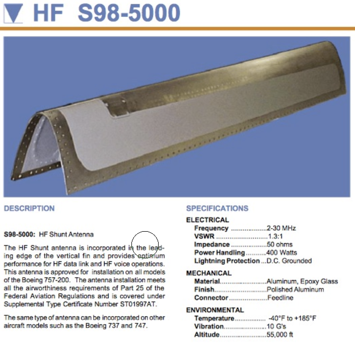

The antenna is actually part of the leading edge of the stabilizer.

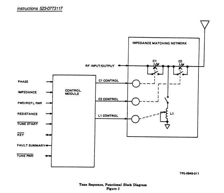

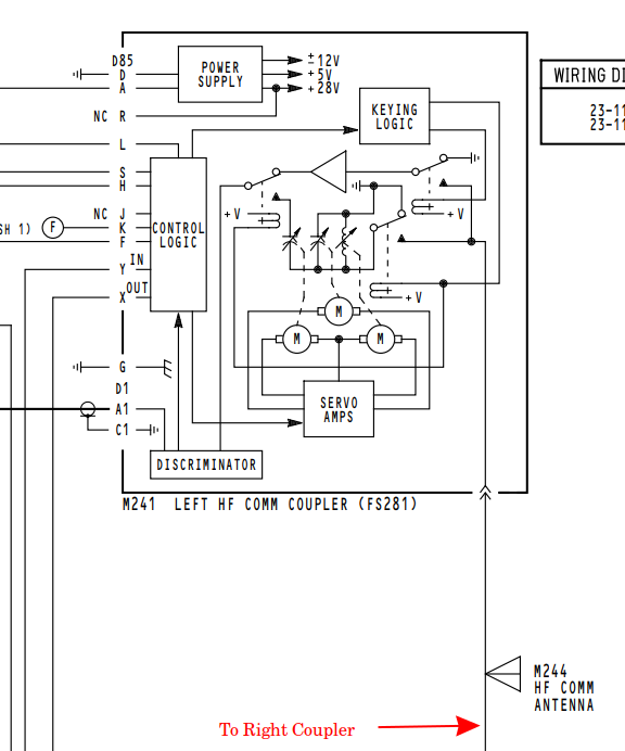

The coupler plays a significant part in the system as it "impedance matches" the R/T to the antenna for each frequency selected. As a note: antenna length is determined by frequency. The higher the frequency - the shorter the antenna. 1090Mhz (ATC, TCAS, DME antennas are about 2" high. VHF 118.000MHz - 136.975MHz antennas are about 18" long. The HF antenna is a fixed length, but HF frequency range is quite large. The coupler has three motors that drive two variable capacitors and one inductor which "tune" the antenna system for best transmission from the R/T.
When the panel frequency is changed and the microphone keyed, the coupler will begin to tune for the newest frequency. A tone is heard through the speakers or headset during this tuning cycle. After the tuning stops, actual communication can begin. The tune time is short for small changes to frequency (let's say 13.567 to 15.986) and longer for greater frequency range changes (3.456 to 20.876).
Tuning is not needed for reception frequency changes.

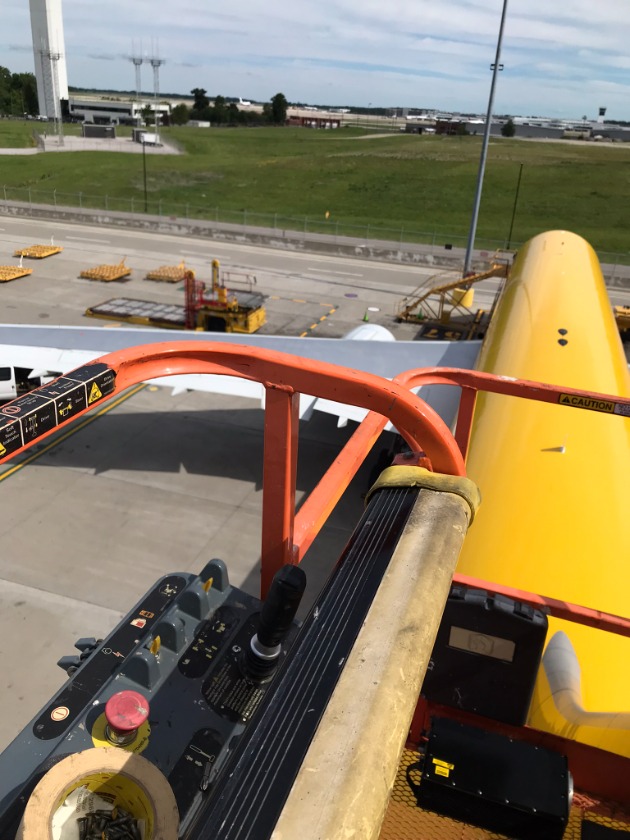

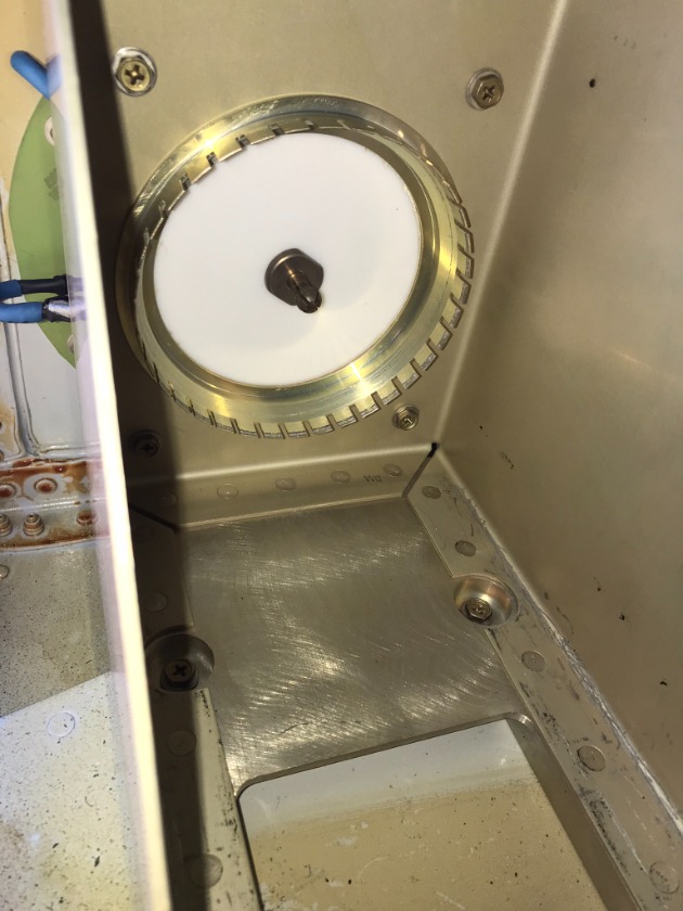

When the R/T swap doesn't fix your issue..... out comes the man-lift. With the coupler out of the rack, continuity to the antenna can be accomplished with the big center pin to ship's ground.
The co-ax can be continuity checked to the R/T rack connector with a  jumper at the rack on the center pin attached to ground. A megger check can be done with the rack jumper removed (I usually get 9+ MΩ's at 250 volts, 8+ MΩ's at 500 volts, 7+ MΩ's at 1000 volts, center conductor to shield). The shield is connected to aircraft ground as a normal function so it needs to be checked at both ends (rack and coupler sides).

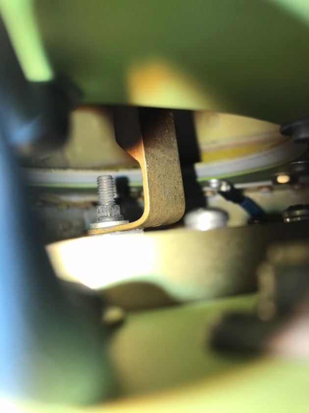

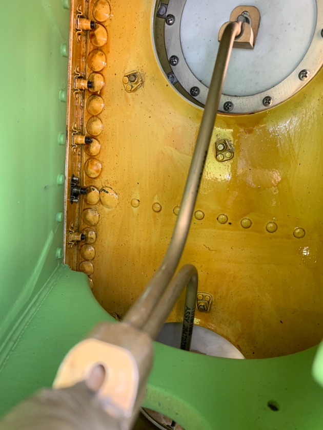

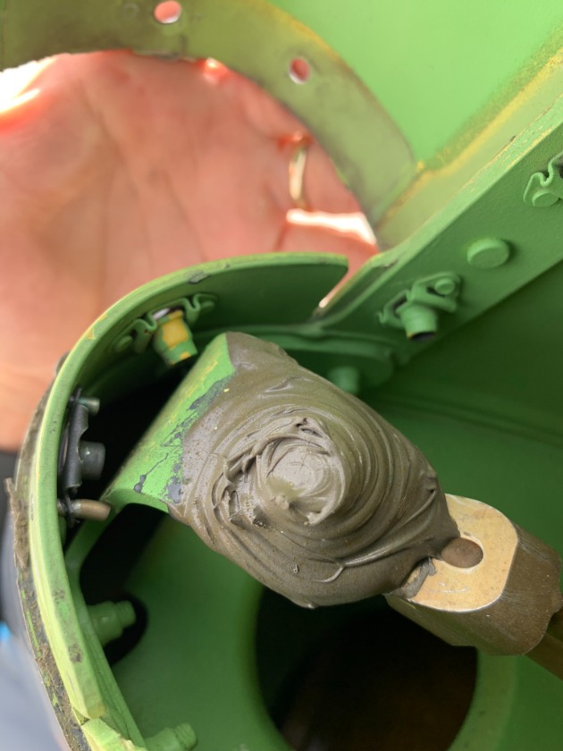

Behind the racks where the couplers are seated are two ≈1/4" copper(?) tubes joined together and bolted to the top of the antenna itself. The connection is covered with sealant.
Could this connection be corroded enough to cause bad reception/transmission of HF signals? Possible, but I haven't seen an example over the course of my time on aircraft.
It would take digging all the sealant off, disconnection, cleaning everything up, re-connection, and re-sealing, to correct an issue like that.
The "ground" side connection (or ground path) of the antenna is actually all the perimeter screws that hold the antenna to the vertical stabilizer.
