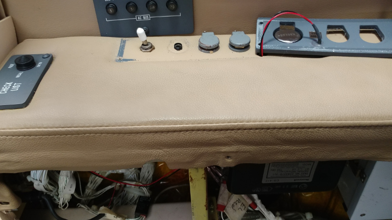

Customer requested both side's microphone and headphone jacks to be replaced. Simple enough job?? Not hardly.
Time only allotted for replacement of the right side jacks. The "plan" was to do both sides, but my favourite three words in aviation (gain access to) played a huge part in that not happening.
The jacks are mounted far outboard on the side panel.
The seat must come out. The side-wall must be removed which also entails the rear chart holder shelf come out. The shelf blocks one "special" screw attaching the side-wall.

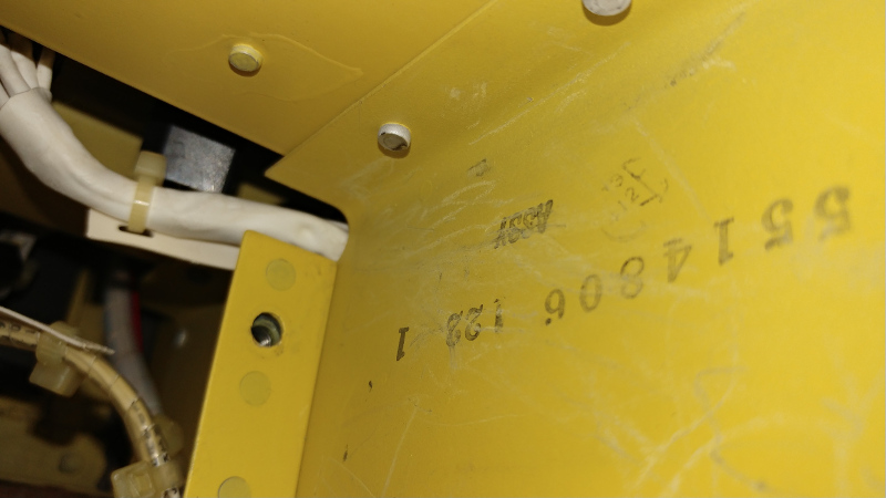

Take a good look at the vertical structural member in the image above and the placement of the jacks in relation to the member.

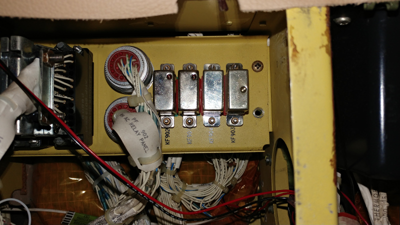

On the front side...... a small relay panel.

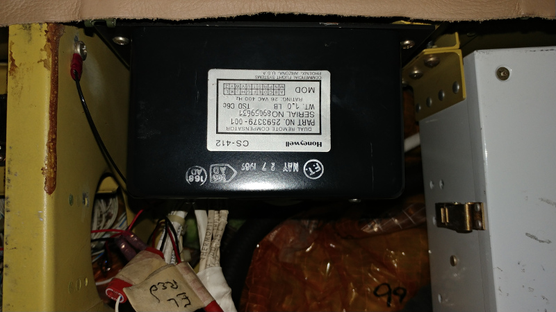

On the back...... a controller of sorts, block access to the jacks.

The forward jack (microphone) must be fed though a small slot located outboard on the vertical member.
But..... when the holes are so damn tight...... you can't push the jack(s) into position because you've got no finger dexterity to push up. A reaming tool was used to widen the holes.
