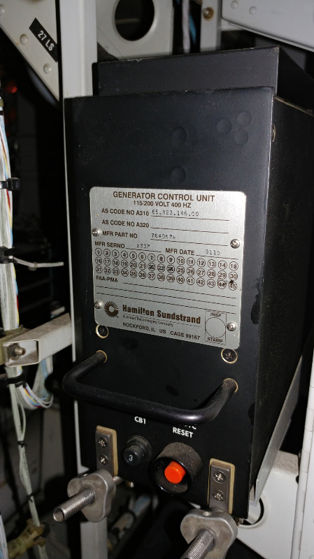

The IDG oil level was verified to be normal. Over-filling will cause high temps. There was no smell of fuel in the oil (cracked fuel/oil exchanger). To rule out a indication issue, the temp bulbs were checked at the GCU rack. Two bulbs, one oil in - one oil out, can be checked at the GCU rack plug on three wires (one common between the two). The #1 engine's in/out read around 122 ohms approximately an hour after engine shut down. These readings matched the #2 engine.
