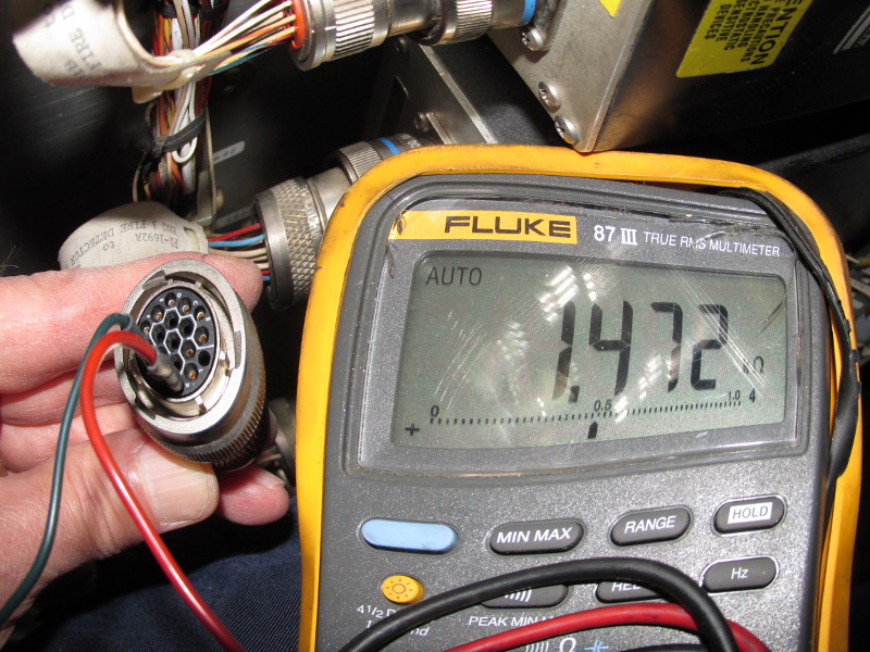

Power, ground, and loop resistance. Power 28VDC - pin"A", Ground - pin"B", Loops - pins "J" and "K".

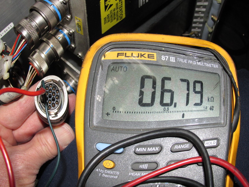

I found good power and ground. I read the readings below for each loop.
Which one is right? Grab a plug from another engine, 1.4KOhms.
I've got a hard open. I'm reading one (of four) loops which just so happens to have a resistance of 6.8K all by its lonesome.

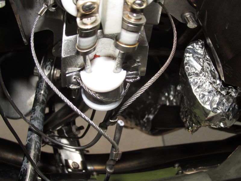

Pop the cowls. Turn on a flashlight. "It" was found pretty quickly.
Snapped loop, just below insulator. I don't recall seeing one snap in half like this, usually it's a wire harness or a loop faults internally.
