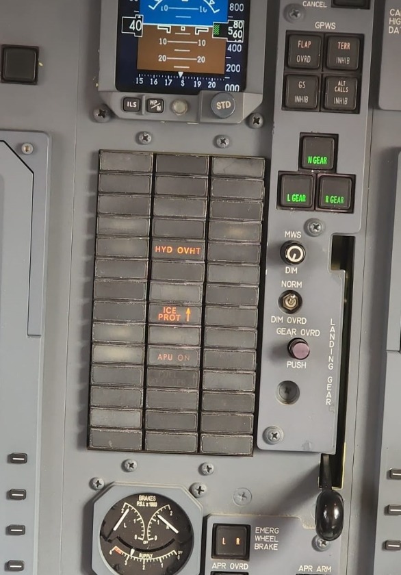

Working on Hawker 900XP with an intermittent HYD OVHT MWS light.
This fault has some history and they had the reservoir temperature sensor changed at the last MX visit. Typically, the fault comes when its above 100 degrees out and the aircraft has been sitting on the ramp with the APU running.

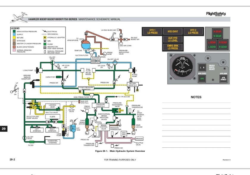

First things first the aircraft has no traditional hydraulic cooling system to investigate so the manual states that a component is bypassing causing the reservoir to raise in temperature and eventually send the OVHT MWS.

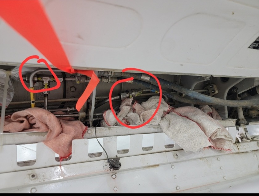

At this point we decided to go after the low hanging fruit and disconnect some of the main component returns to see if they bypass under pressure. We tried nose wheel steering, brakes, emergency brakes, main accumulator discharge handle. All of these components check good so we decided to start digging into it.
Next thing we did was to cap the hydraulic pressure manifold inlet line, this will isolate the components side from the full flow relief valves and other upstream components. With this capped we now have a passing test, which tells us that the issue is downstream of the pressure manifold.

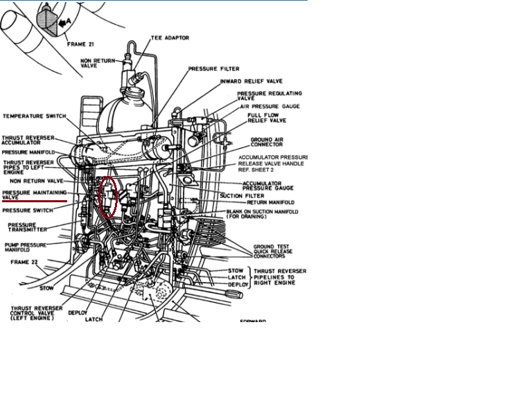

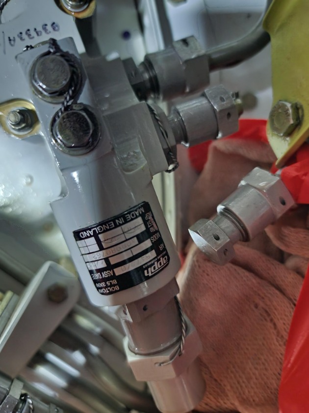

At this point we decided to check the pressure maintaining valve located underneath the main reservoir behind an access panel for bypass. We had to fully isolate the other systems from the pressure manifold leaving only the maintaining valve in the system and performed the test again. We found that the maintaining valve  was bypassing. At this point I plugged the return side of the maintaining valve and tried the test again all good. I reconnected the systems one at a time retesting each time and still everything passed. Pressure maintaining valve confirmed to be the defective part. Removed and replaced the part and aircraft was back in service without issue.
