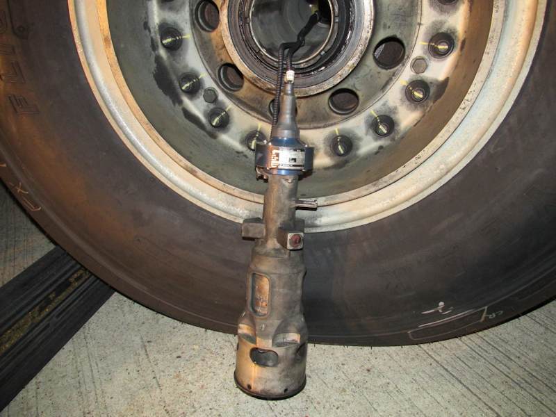

Fan cover off.

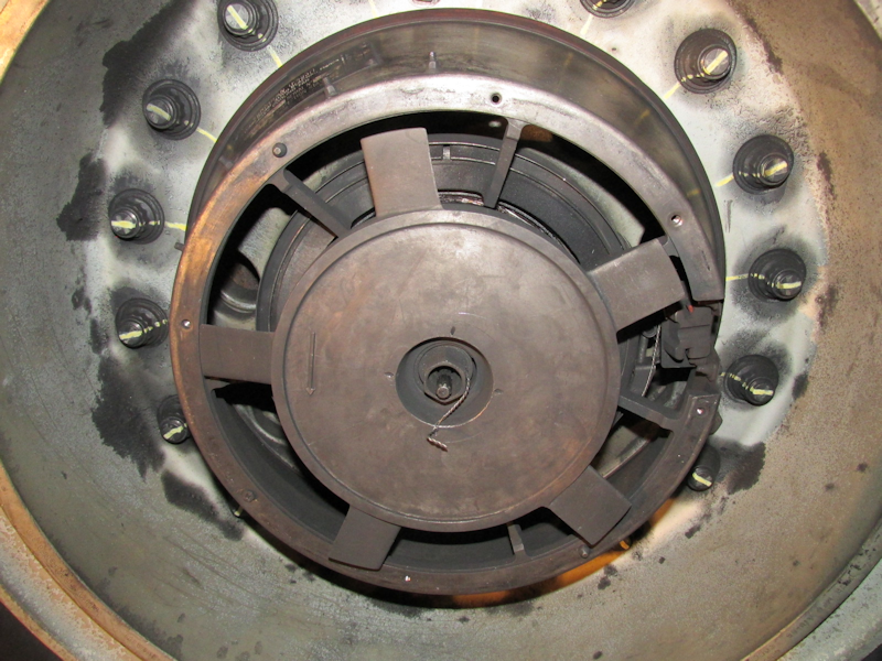

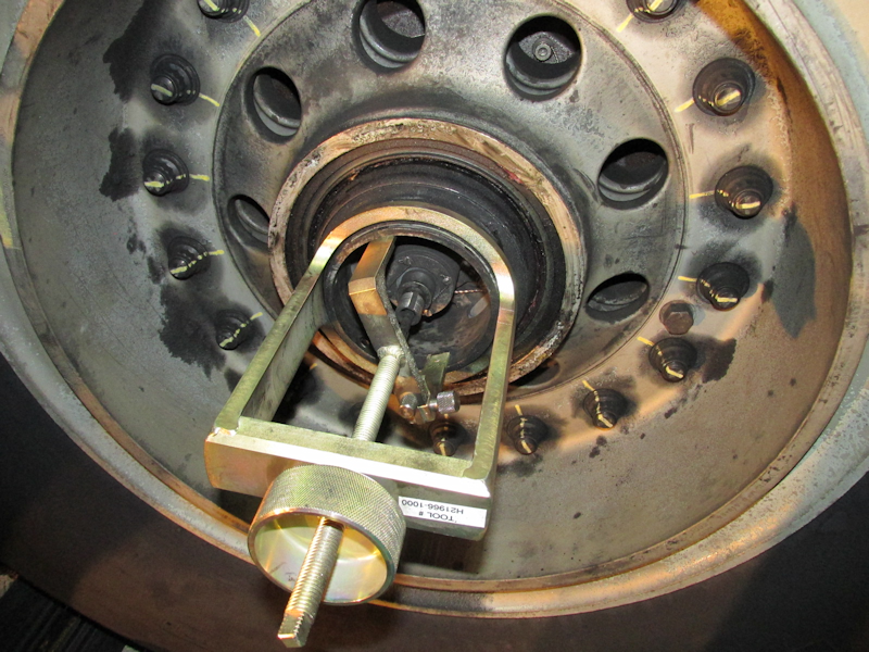

Fan, shroud, and mount bracket removed. Puller installed.
Tach and fan motor ass'y out.

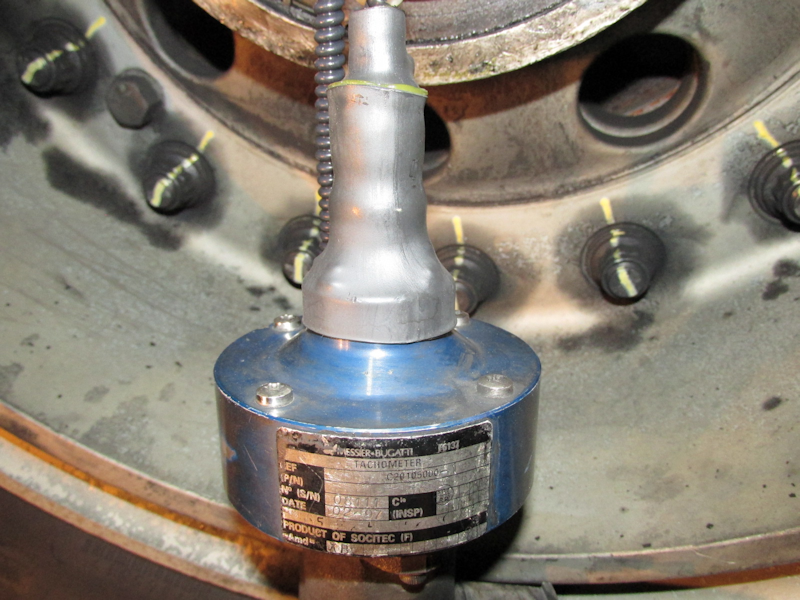

Wheel speed tachometer.

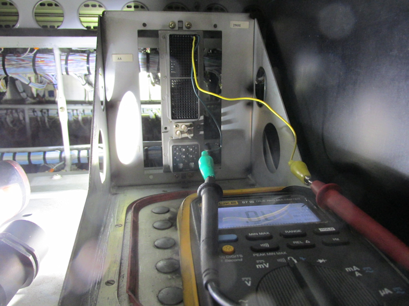

BSCU rack plugs.

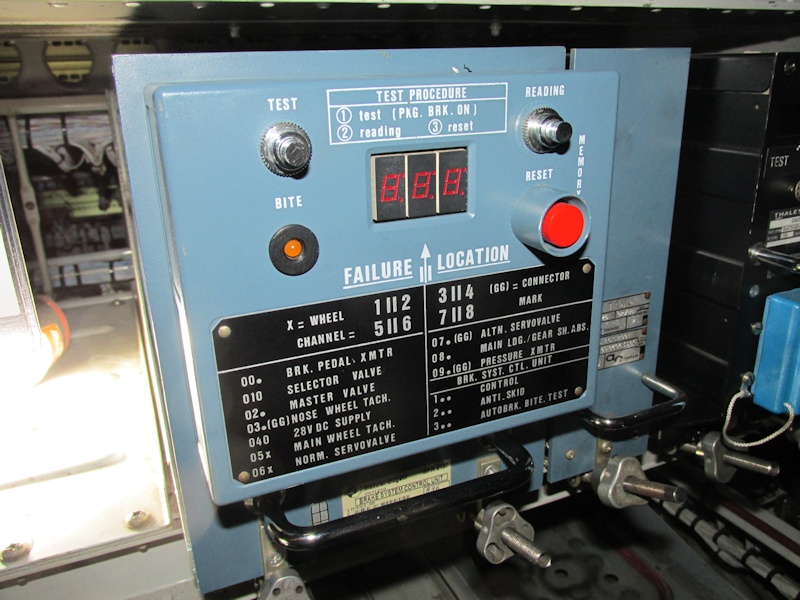

BSCU.
We verified that the plugs were not swapped with a simple continuity check. In this case rack plug "AA" pins "1A and 1B" to the tach pins "A and C".
We also checked resistance of the tach itself and compared it to another one (in this case #4) both read around 470 ohms.
We replaced the BSCU because of a previously seen microprocessor fault (which we could not duplicate) and sent the aircraft on its way. I have no doubt the problem has not been fixed. Given the time, I would of started to look strongly at the anti-skid control valves as the source of the problem.
