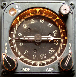

With an old RMI (C4 or C14 type???) like this one.
The RMI is the workhorse. The Compass Rack would have two removalable amps, servo and slave. There would also be a circuit breaker on the front face of the rack. This breaker is the 26VAC for the flux valve. The HUGE issue with these older systems is the plug connection at the RMI. A plug that isn't seated "fully" will cause all kinds of crap to occur with the compass system or outputs. ( I did a road trip to Austin on an MD-80 to fix a bad #1 compass. My fix???? Pull the capt's RMI, verify no bent pins, and re-install plug TIGHTLY. Problem solved and I still had some time to go slug down some beers. :P
