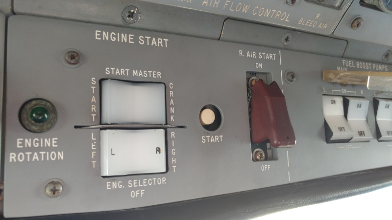

The starter has a centrifugal switch built in. (Switch plug not visible in this image. On the left engine, the starter is mounted inboard next to the pylon. The plug is at the 2 o'clock position when viewed back to front.)
This switch is normally closed until a set rotation speed is surpassed during start. Its only purpose is to provide a ground to the start control relay located in the 169 panel behind the entrance door. This relay, when energized, provides 28VDC to the starter control solenoid, initiates ignition, and stops generator cooling air. Those items will remain in that condition until the centrifugal switch opens up (engine at a speed where the starter and ignition are no longer needed). The relay de-energizes, the start valve closes, ignition stops, and generator cooling resumes.

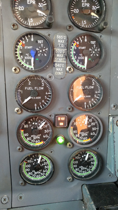

Engine at 14%. Start valve and ignition lights on. Green rotation light on.

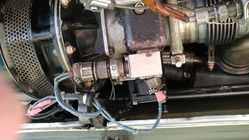

We verified power (with start commanded) and ground at the cannon plug pins. The "assumption" was a bad centrifugal switch in the starter.
We were wrong. After the starter was removed, giving a clean view of the switch cannon plug..... both wires were hanging by just a few strands (which would explain the intermittent problem). The wires were repaired and the original starter re-installed.
Some folks might question how 28VDC was read at the plug on the engine: A relay coil can be considered as a regular wire when the relay is not energized. The relay is not working (dropping the voltage) so a full 28VDC can be read on the back side of the coil. If the relay were energized, 0VDC would be read, as the wire is now grounded and all voltage is dropped through the relay coil. Short explanation.
