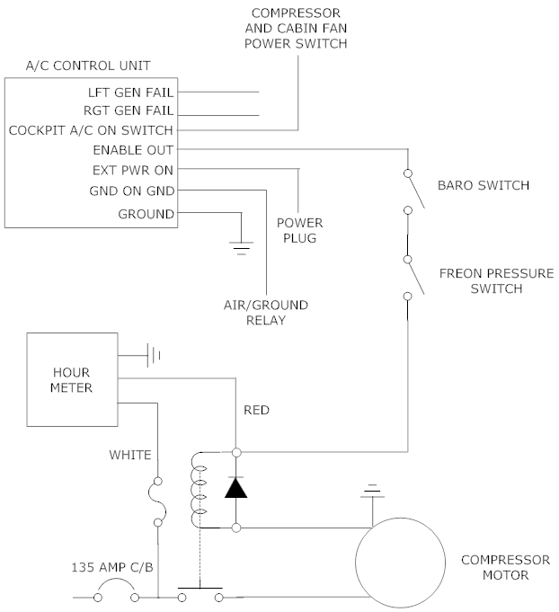

The compressor system uses a control unit to power a large contactor which feeds 28 VDC to a compressor motor. This motor has a large drive belt which spins the actual compressor.
Without access to the maintenance manual, some basic control logic functions can be understood. The controller needs to see the aircraft on ground using external power. It also requires a 28VDC signal from the cockpit switch. There are inputs from the generator system, but their function is unknown. If all the prerequisites are satisfied, the control unit sends an enable signal (28VDC) to the compressor motor contactor.

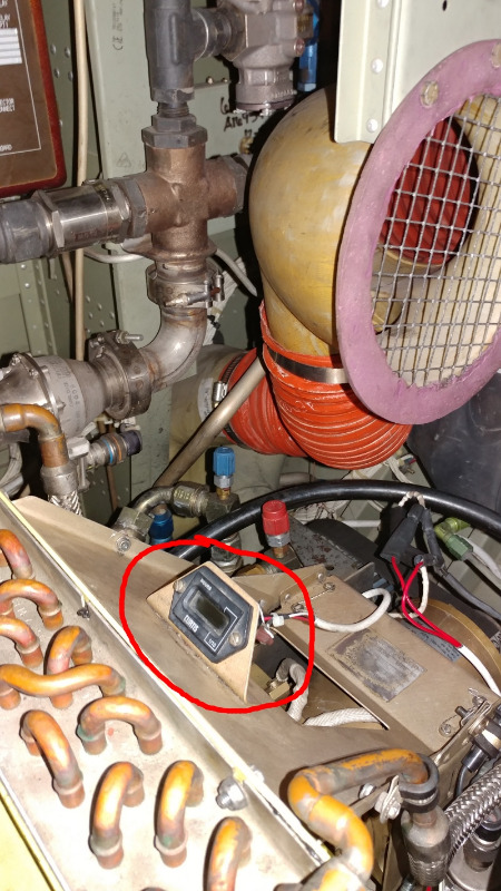

With that being understood, it was now time to determine if or why not voltage was reaching the contactor coil. An easy way to accomplish this was the hour meter. The red wire feeding the hour meter is tied off of the coil input enable signal. No voltage was found. Just to check the main power feed from the 135 amp breaker was present, it could be checked via the hour meter's white wire. Power was present on the white wire.

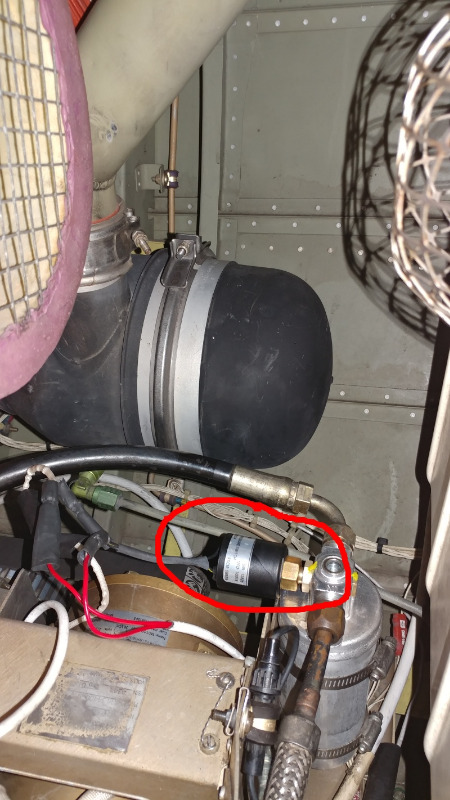

This left only two intermediate pressure switches as a possible problem. A barometric switch and a freon pressure switch are wired in series to the contactor coil. I have no clue as to what the baro switch is used for. The freon switch is mounted on top of the receiver-drier in a horizontal direction.
I was very lucky that the wiring was easily accessible to the freon pressure switch. After sliding back the heat shrink, voltage was found on only one of the connectors ( knife splices ). The open pressure switch was bypassed for just a brief second with a jumper wire. The contactor closed and the motor started running.
Switch replacement required a purging of the freon before removal and a re-service after a new one was installed.

Sometimes, the freon pressure switch does exactly what it was designed to do. With low freon pressure, the switch opens. This prevents compressor damage, but it can open a can-of-worms if the system has a leak that must be found and corrected.
