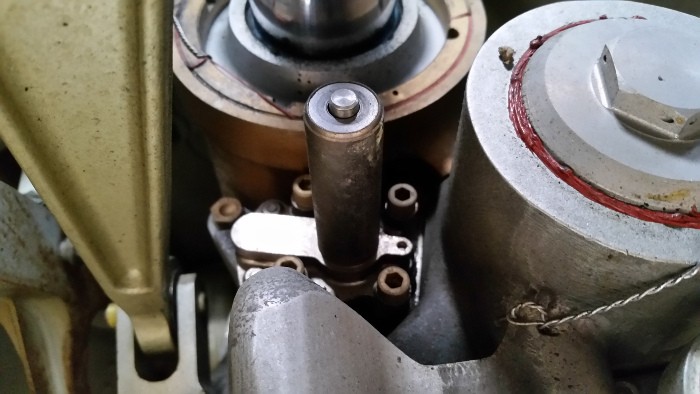

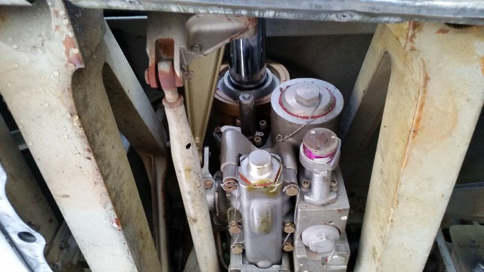

View with access panel down.
A little closer shot. Rod end can be seen protruding at end of housing.

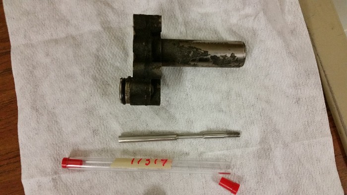

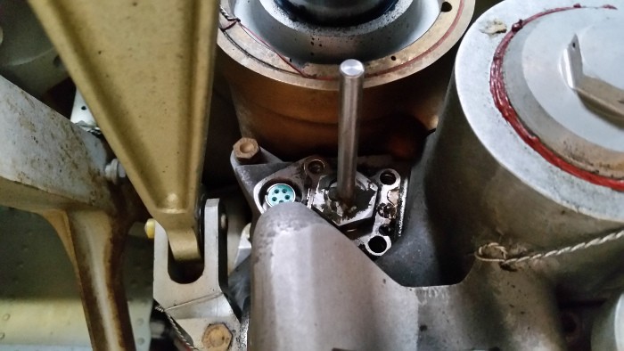

Four Allen screws.... and off she pops. The screws are "not" safety wired.
The AMM does not mention changing the movable rod. I never have and I would be concerned about placing any type of tool on it to loosen it up.
All previous changes of just the outer housing have performed correctly.
Old housing with (unused) new rod.
