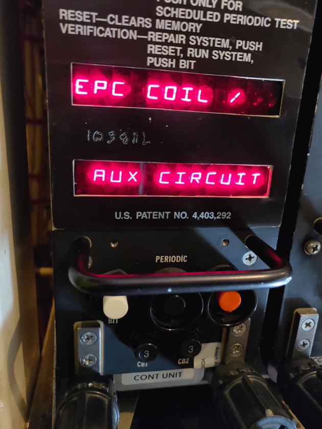

767-300 that would not accept external power.
Fault message on front of BPCU (Bus Power Control Unit).

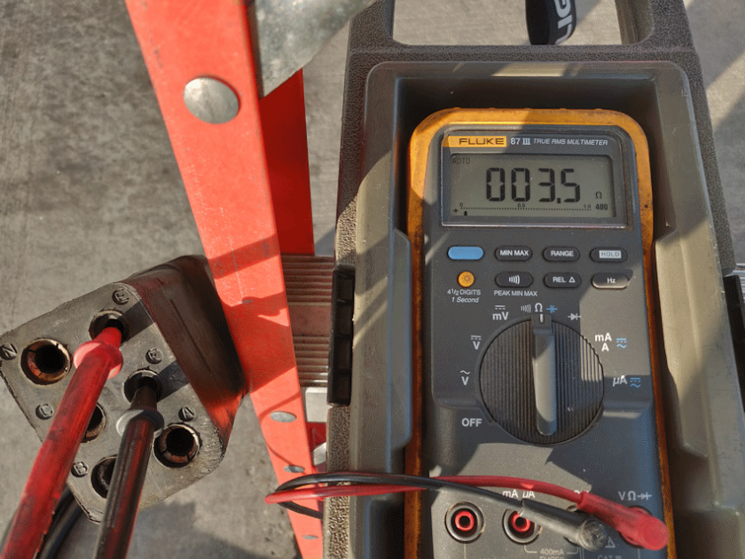

This message is associated with the BPCU seeing a valid interlock circuit or a external power contactor coil problem. The interlock deals with pins E&F of the external power GPU plug. The BPCU must see continuity between these pins before allowing power to the aircraft (Reference: rotate.aero/forum/safety-aware/265-external-power-plug#452 . As far as the contactor coil, if the BPCU supplies a signal to close the contactor, but it does not close, it will log the fault shown above.
Pins E&F can be checked directly at the plug.

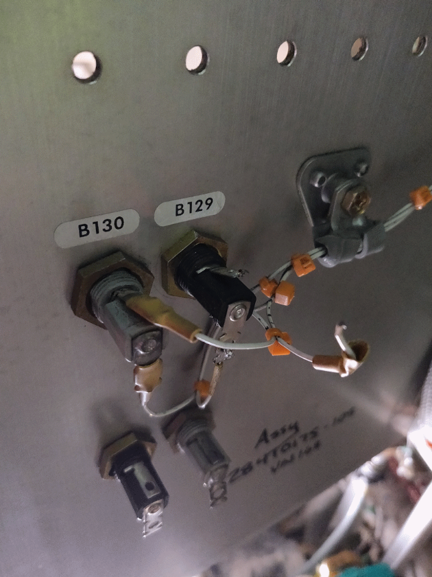

In the case of a 767 (most likely other types of Boeing aircraft), two fuses are placed inline from pins E&F of the external power receptacle to the BPCU. I found a broken solder joint on one of the fuses.
The broken wire was spotted almost immediately upon opening the P34 panel. I still wanted to verify operation of the external power contactor. The BPCU supplies approximately 28VDC to close the contactor. I tried substituting my "easy 28" rotate.aero/forum/test-equipment/246-easy-28#409 , but because the contactor is so large...... there wasn't enough power from the batteries to close it.

Make sure I understand this- pins E & F on the aircraft side won't be a completed circuit until the plug is inserted and the contractor closes.
6 years 9 months ago #635 by Mark
Replied by Mark on topic ATA 24-40, External Power
The GPU doesn't have to be making power for there to be continuity on E & F of the plug. The image above was on a non-running GPU.
You've got me thinking though. Why does a GPU throw a E&F code when it's not pushed in all the way?
I'm going to have to put a voltmeter on those fuses on a externally powered aircraft. I'm kinda thinking I'm going to find 28VDC on one.
