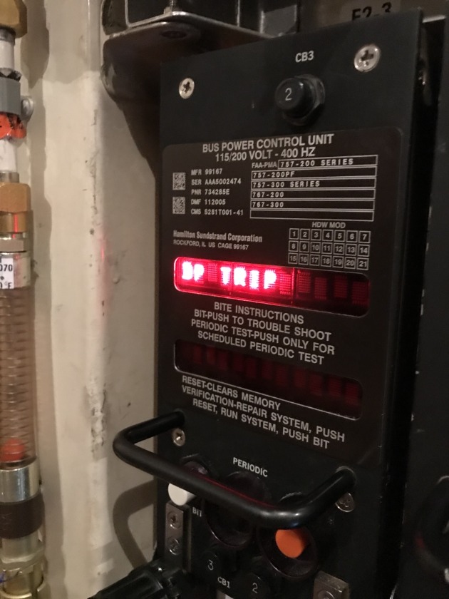

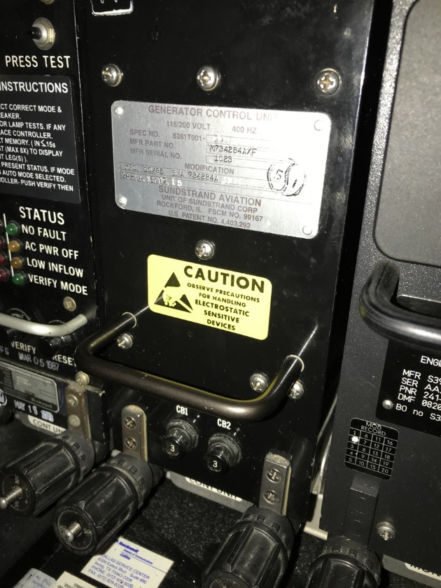

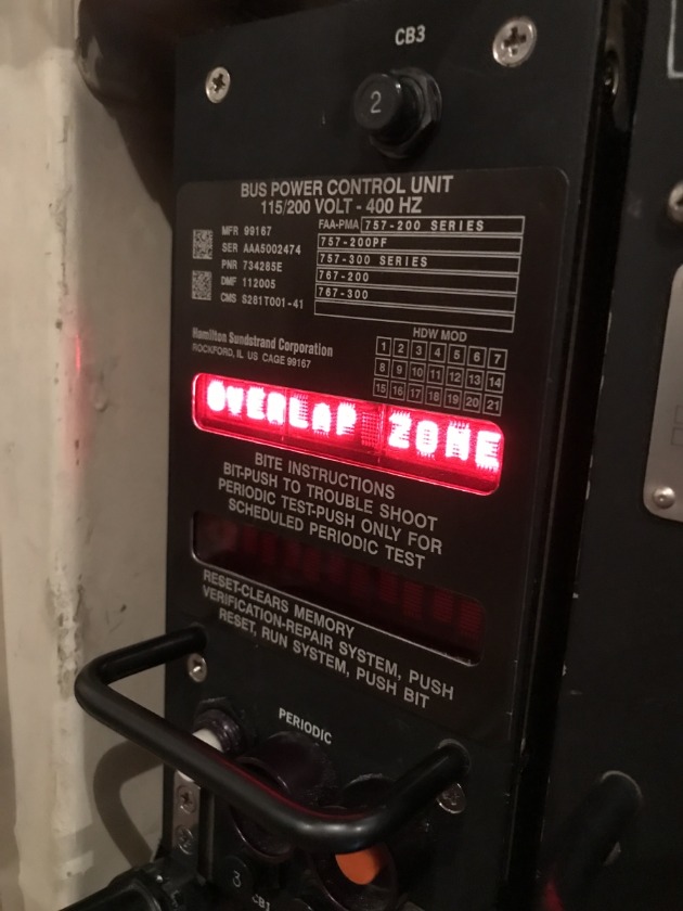

We had two fault codes on the BPCU (Bus Power Control Unit).
Please excuse the shitty pictures.
DP Trip
DP is differential protection. The system senses a difference in amperage loads on the three wires. Either one is open (carrying no load) while the other two are good..... or one wire is shorted to ground, carrying a huge load compared to the others. This doesn't have to be just one wire either, two messed up wires will still cause a DP trip.
Overlap Zone
I really couldn't figure out the "Overlap Zone" from either the Fault Isolation Manual nor the Maintenance Manual. For the engine generators, there are current transformers labeled overlap, but I didn't see any for the APU.

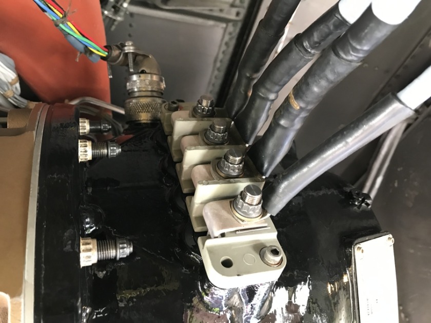

For this problem we found the phase wires installed incorrectly on the generator itself.
To verify the correct wiring we took the three power leads off the generator and shot from the Generator Control Unit rack plug.

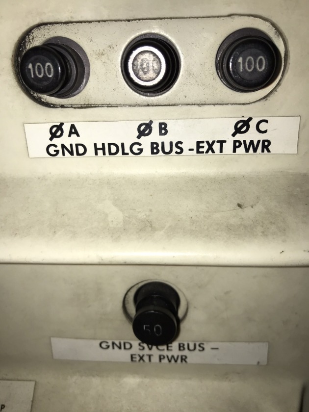

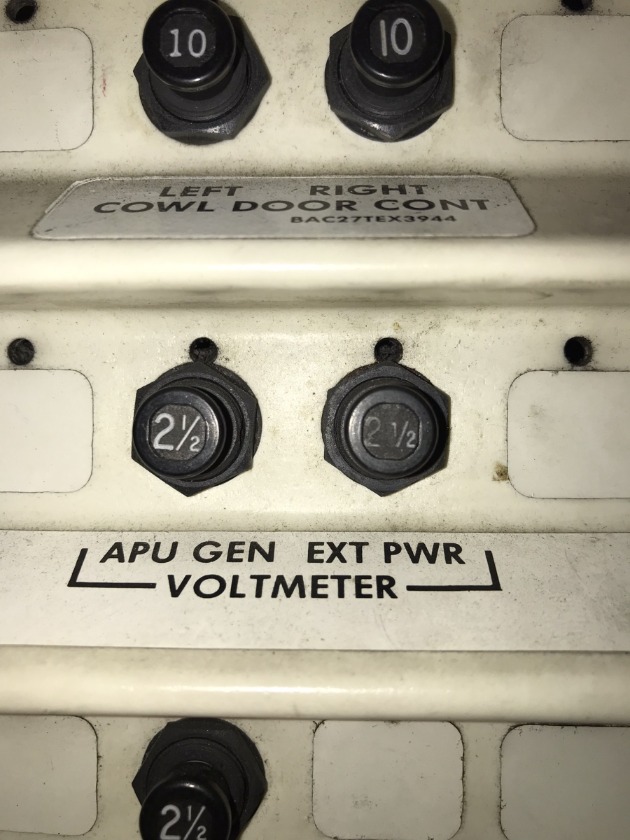

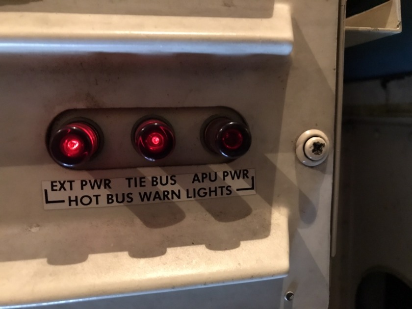

To isolate the system to just the three power feeder wires, some ground service breakers and the APU Generator voltage feed to EICAS breaker had to be pulled. The red "Bus Hot" light had to be removed from its socket also.

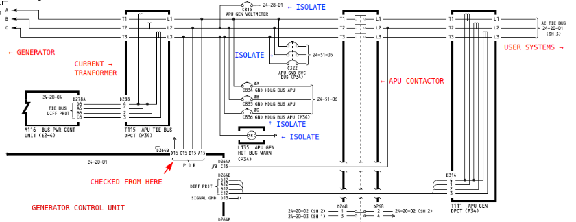

To verify wire continuity for the specific power feeder terminals, any extra paths to ground had to be isolated from the wires being checked.
From the drawing below, it can be noted some circuit breakers and a light bulb were connected to the feeder wires. The breakers were pulled and the light bulb removed. The APU contactor was not energized so nothing downstream from it would be considered connected.
