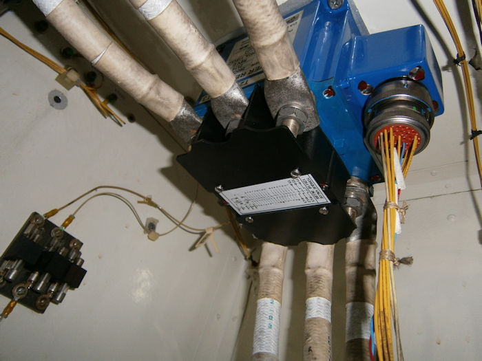

The #3 BTR (R2-6) is located in the right A/C power bay. It is mounted upside-down on the lower shelf. (One note: These bus transfer relays are really contactors as they are carrying large amperage loads.)
Two of the "Sense Fuse's" can be seen on the left.

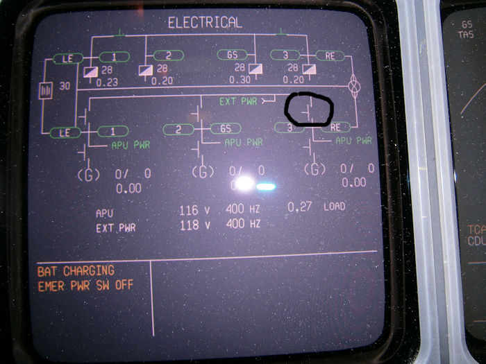

This is a poor image, but the "#3 Bus Tie" is showing open as the APU generator is powering the aircraft. The bus tie would be closed on external power. The bus tie is also closed with the #3 generator online and paralleled with the other two engine generators. (Paralleling is a matching of sine-wave outputs of the three generators. Pretty amazing engineering of the IDG's or Integrated Drive Unit's if you ask me.)

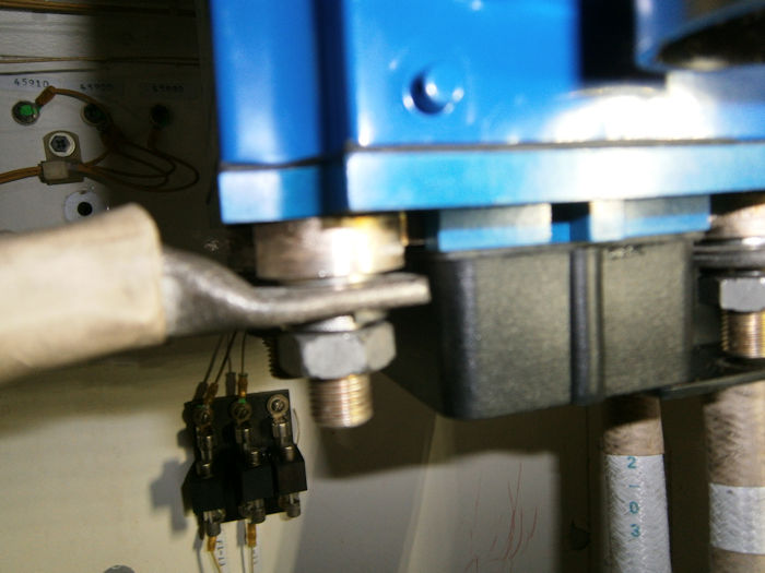

Another poor image but, one thing I did find on the installed unit was the wrong placement of the flat washer. It was installed under the terminal. This is not correct. The proper order is terminal, flat washer, lock washer, nut.
