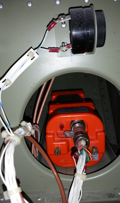

(This is just a simple endorsement. We are not being paid for it, but when something works quite well....... it should be mentioned.)

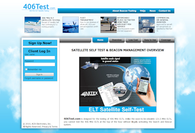

Testing of 406 ELT's usually require a special tester, www.edmo.com/index.php?module=products&f...isplaycat&catid=1640 , these range in price from $1500 to $3000, but ................ there "is" another way to get it done.
Visit www.406test.com/home.aspx?ReturnUrl=%2fmain%2faviation.aspx $30 for registration and $30 per test. Not a bad deal and the procedure takes about 10 seconds, if that. Sweet!!!
For reference, a Artex ELT maintence manual, 570-5060 - Rev K, dated 12/1/14 is linked below. Any updated manuals can be obtained from Artex's web site, www.acrartex.com
