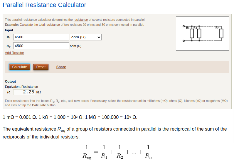

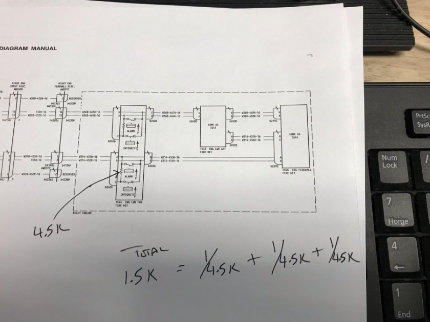

CF6-80A and CF6-80C2 that use Systron fire detection systems have three equal resistance loop sensors. Each loop measures 4.5K Ohms. They are wired in a parallel circuit.
In a functional system 1.5K Ohms should be read at the fire detection card pins 19 & 20.
If 2.25K Ohms is read..... you've lost one loop. If 4.5K Ohms is read..... you've lost two.

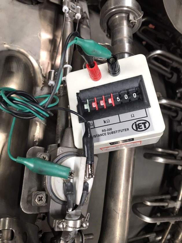

If a bad loop has been isolated, throwing a decade box across the terminals should at least give you a valid test from the cockpit.

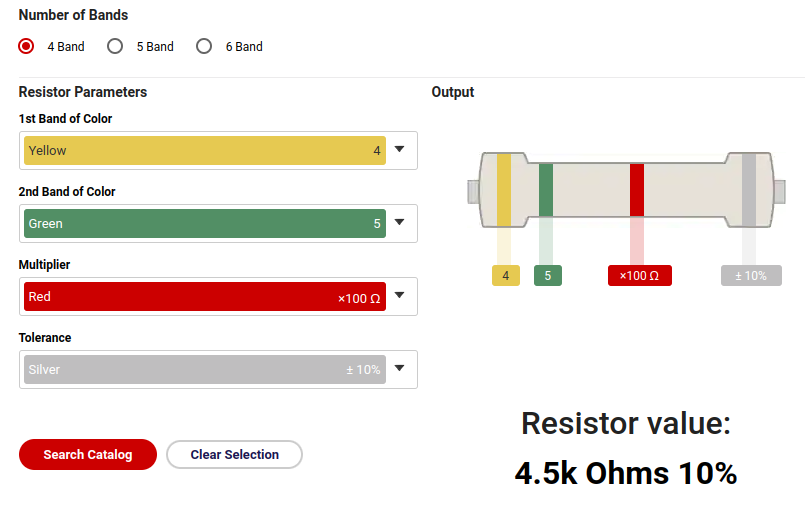

Or..... just throw a 4.5K Ohm resistor across them.
