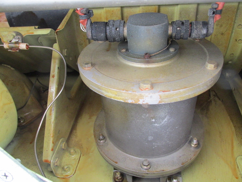

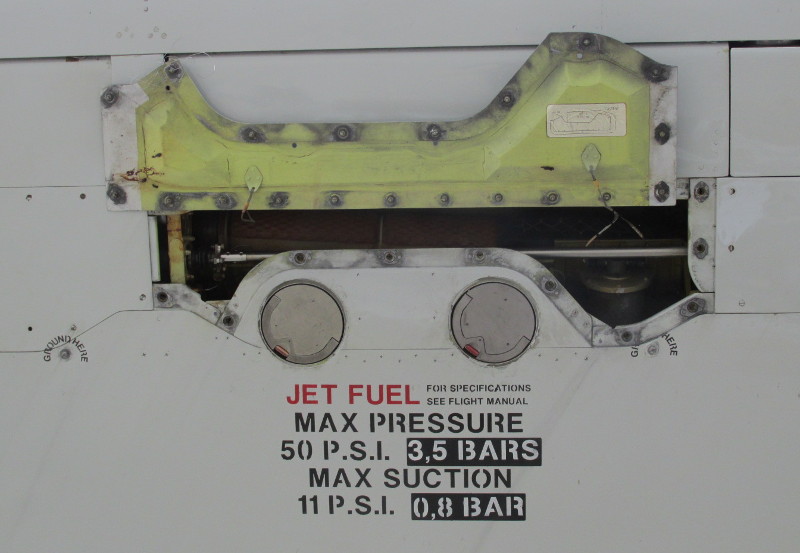

The unit is located just inboard of the fueling nozzles.

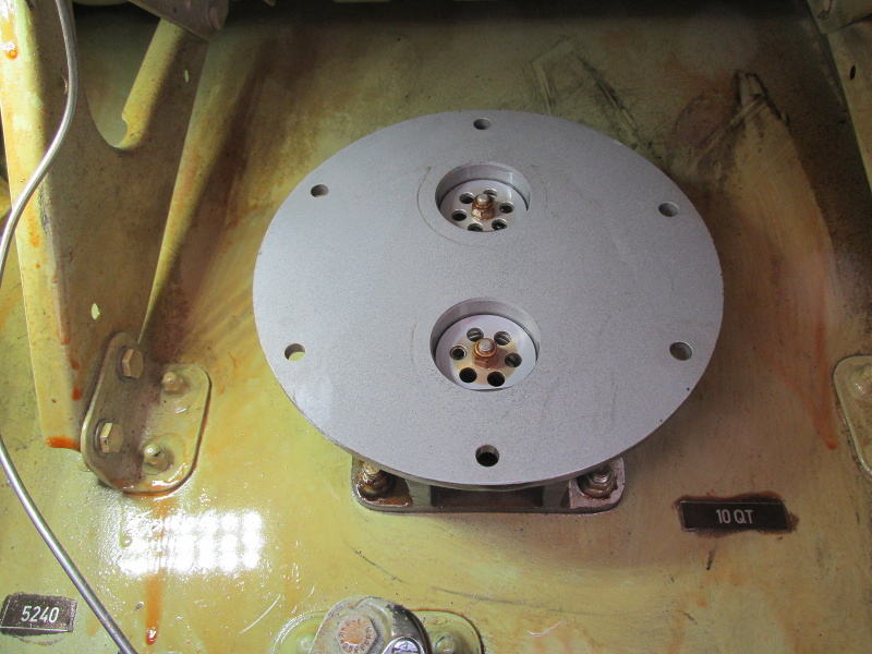

Mounting plate with unit removed.

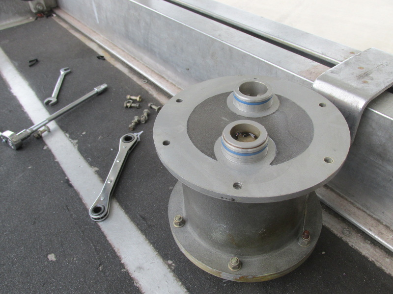

Back of unit.
The preferred "weapons" were a 3/8" open end wrench and a 1/4" socket with a six inch extension. The silver drive rod (visible in top image) had to be pulled forward slightly to wiggle the cadensicon out of the wing.
