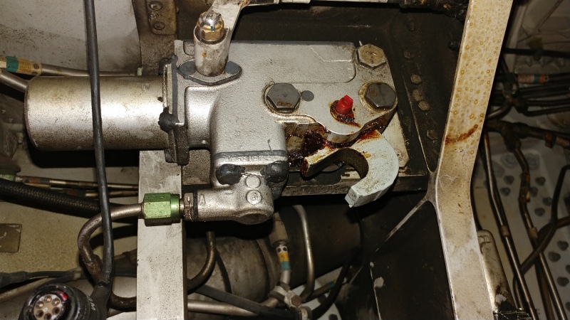

Left main gear up-lock switch with plug hanging off. The proximity switch is located in the silver barrel on the left side of the hook actuator assembly.

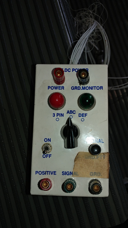

We used a small test unit for proximity switch operational checks. I found this box here online. The gear locks themselves can be easily activated or reset with just a finger push.
