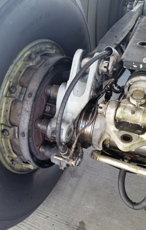

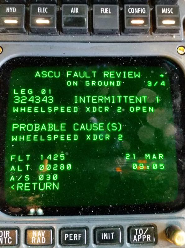

MD-10-10 with the #2 brake locked out and the #2 wheel speed transducer disabled in the Anti-Skid section of CFDS.
Previous troubleshooting was limited and as par for FedEx...... a wheel speed transducer was changed which did not cure the problem.
A quick glance at current anti-skid faults, showed......

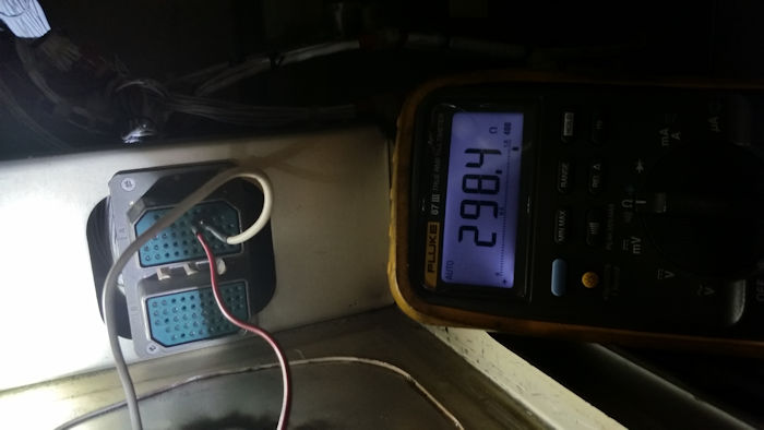

The Anti-Skid Control Unit is in the center electronics bay. A comparison of transducer and manifold valve resistances was needed to "at least" rule out a wiring fault.
A reading on the #2 transducer (pins 12 & 13 of plug "A") showed a resistance of 295 ohms. This matched several other transducers.

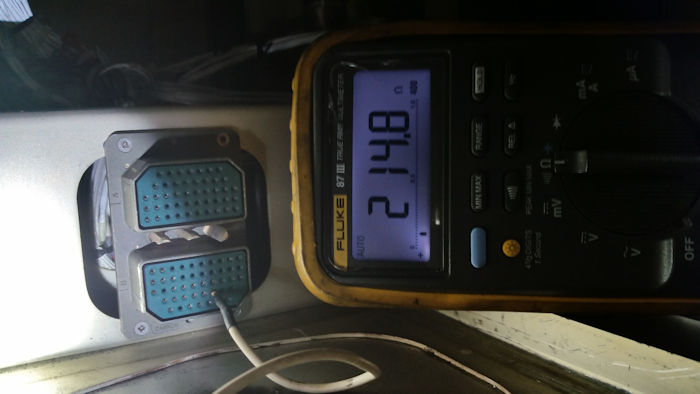

Just to note a typical manifold valve, several coils were also checked. All valve coils are on the bottom (or "B") plug.
All the valve coils checked, fell in around 215 ohms.
