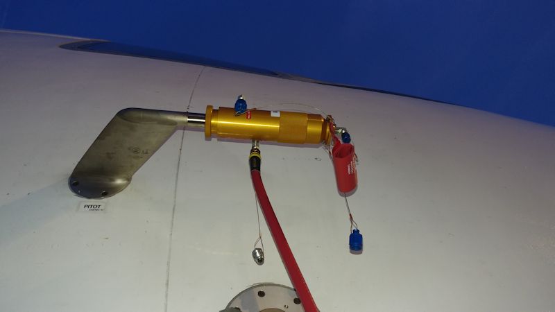

Not having access to a nitrogen bottle and the proper adapters, we used a probe adapter and plumbed a pitot hose on the the static port for the F/O's system. We disconnected the static (self-sealing) quick disconnect on the #2 ADC and taped over the corresponding static port on the opposite side pitot probe.

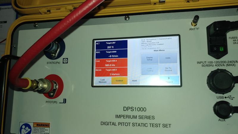

The maximum pitot speed on the test box was 500 Knts. I have no clue as to what this might equate to in PSI, but I would suspect it was no higher than 2 PSI. It was enough pressure to find the leak.

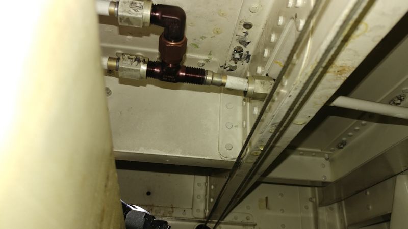

After some digging, bubbles were noted at the T-fitting where the left and right systems meet. This was in a very difficult area above the nose gear well area.
The fitting for left static input was at fault. After removing and reinstalling (with some serious torque), we still had the leak. After further investigation..... the flared swage at the end of the tube was able to be spun. It should not move at all.
(View looking aft.)
The line from the aircraft left upper probe to the T-fitting required replacement.

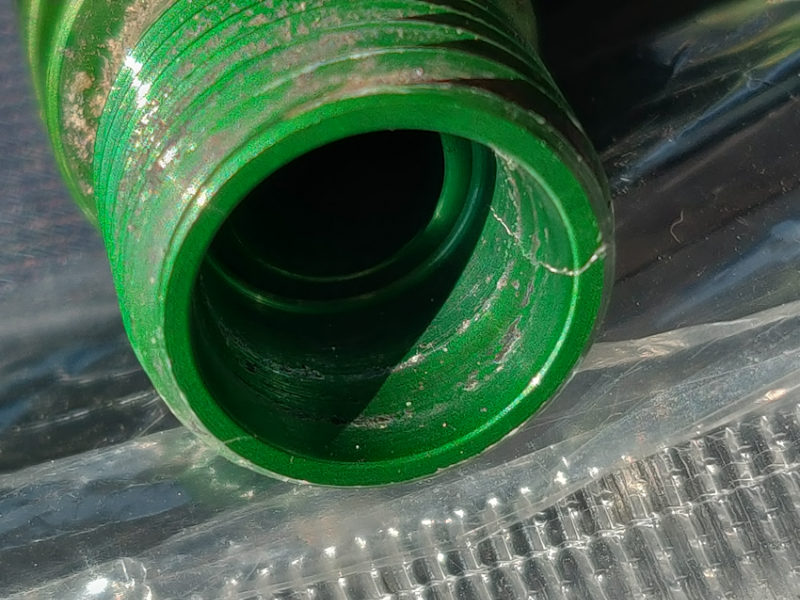

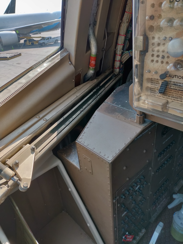

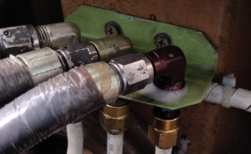

With the quick disconnects off the #2 Air Data Computer, we plumbed 400 knots airspeed into the static system. Everything sprayed with leak detector down in the E&E was good. We found the leak at a elbow union above the cockpit floor. It was where the flex line attached to the probe itself meets the solid lines running down to the computer. We had a small slot to shove our hands through and the replacement was somewhat difficult.
Elbow replaced. The foam is a "goodly" application of leak detector fluid.
Old fitting with crack clearly visible.
