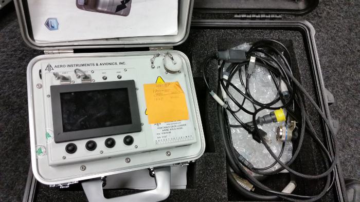

Do you guys load Navigation Databases into your FMCs with a data loader Mark? We have evolved from floppy disk to mass storage device.
9 years 6 months ago #325 by Mark
Pretty much one loader for everything. It's like a big-ol USB stick. All aircraft types - all possible software loads for each one.
FedEx put a nice little download link on all of our computers. We hook the box to a computer and click a single icon. The complete download (for everything) takes about 5 minutes.
9 years 6 months ago #328 by jake ounce
It's similar to that one. Works much better than with the floppy disks. We are constantly loading different databases, especially on the 757 and A300. The 767, 747, and MD11s have worldwide storage capacity. For a while, folks were loading the wrong databases, like UP5-xxxx-xxx instead of UP1-xxxx-xxx, then they made us use Task Cards which forced you to read and review...not rocket science.
