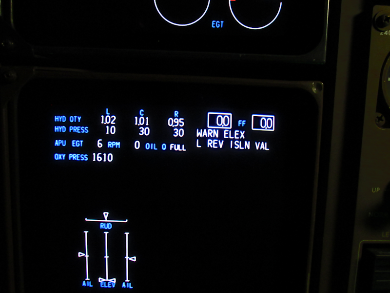

Question....... what causes this warning????

From looking at the schematics, you would think this is a pretty simple issue. The EICAS computers see a ground on pin "H7" of plug "B". This ground would most likely be caused by a stuck (pressure on) T/R Isolation Valve pressure switch.

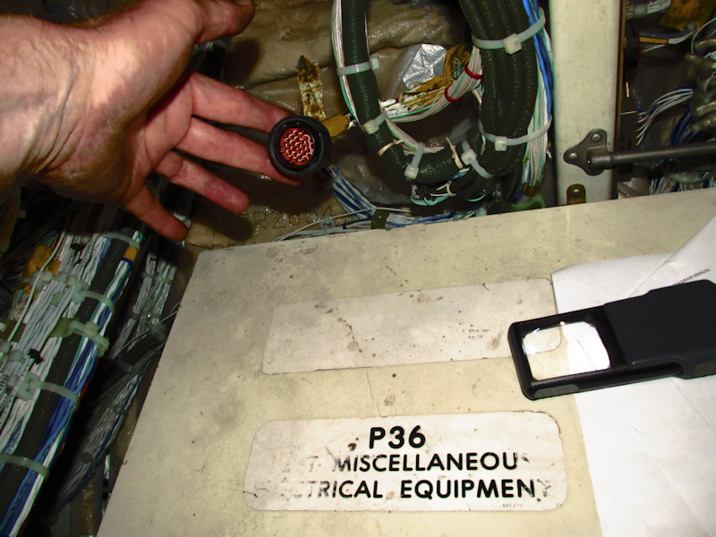

I thought of removing the throttle switch circuit from the system. It was accomplished quite simply by disconnecting one plug at the P36 panel.

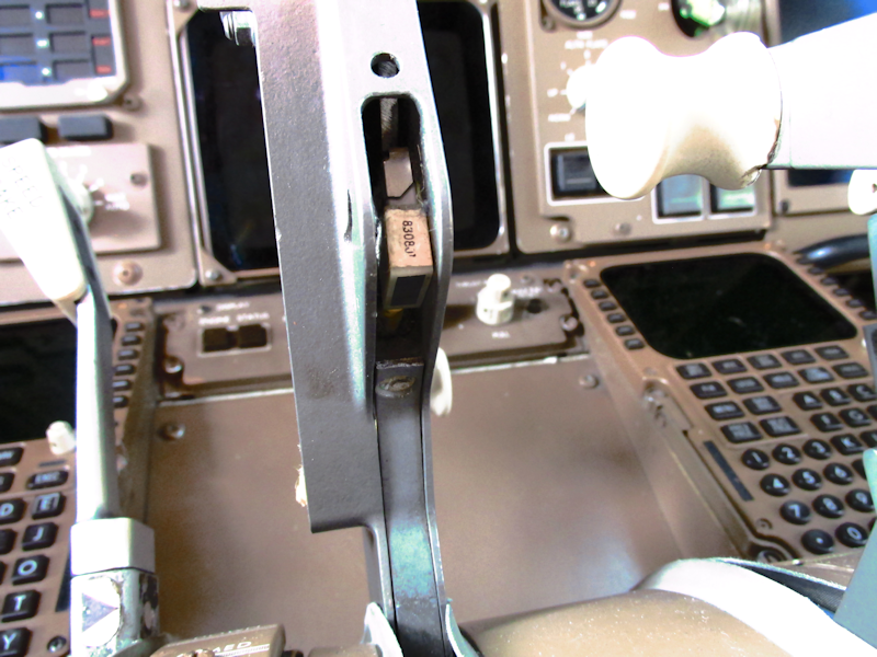

"THAT" switch is a bear.

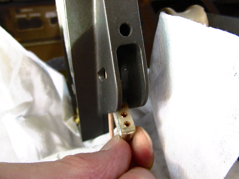

In that little area is the switch, a socket, a shim, and the actuating roller assembly. We changed the switch and let me tell you, it was quite a bitch. We taped over every hole we could find. It was lucky we did because either the screws or shim took flight a few times.
The socket without the switch is shown above. After we changed the switch..... the problem was "still" there. WTF!!!!

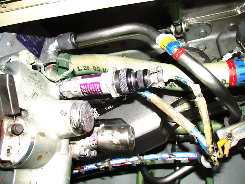

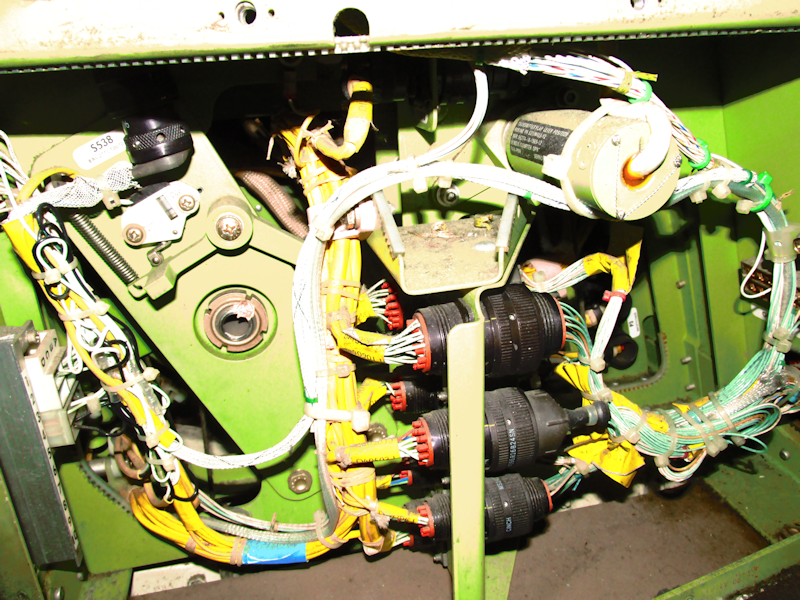

We started busting intermediate plugs off. With each plug removed, one at a time, we lost the ground. The last plug in line is not reachable without gutting the pedistal, but the second last one is....
Pedestal right, upper plug. The ground still was showing towards the switch.
Turns out...... the damn socket wires, right after they left the socket ass'y were shorted. THIS SHORT DID NOT SHOW UP WHEN WE HAD THE SOCKET ROLLED DOWN FROM ITS MOUNT.
