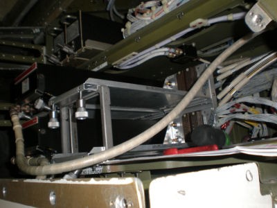

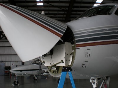

The transponders on a GIV are located under the radome, aircraft left, on the top shelf.

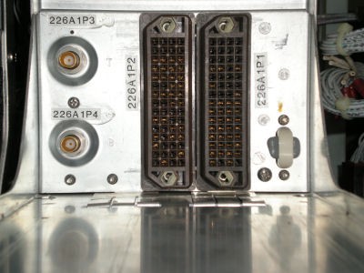

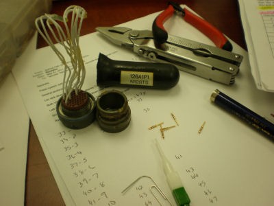

Rack plugs. Strapping is accomplished on the P-1 plug, pins 33 through 56. This generation of rack plugs from Collins uses a flat “fork” terminal that is quite different than the normal type plug that uses round pins. Of course, working with these pins requires a special crimper and removal tools. These are “push out” terminals and they are removed from the rear of the rack plug. The numbering on these plugs can also be tricky. Viewing from the front side: Pin 1 is upper right. Successive pins are read right to left for each row. Pin 5 would be directly below pin 1.

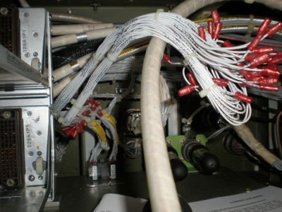

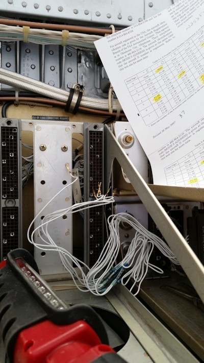

This aircraft has two junction blocks on the outboard side of the racks. Normal thinking would tend to lead to the strapping being done at the blocks. After the wire bundles were opened up, the terminal block wiring led to numerous (disconnected) capped off pins.

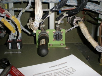

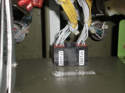

Tracing wires revealed the coding is accomplished at two removable jumper plugs. This is quite a handy option. The jumpers can be removed and recoded in a shop environment instead of messing with rack plug pins or onboard terminal blocks. These two were most likely assembled at Gulfstream and probably are attainable from them, at a cost.
Coding for these plugs took a little chart. The pins on the plug did not match the pins on the rack. They were “32” off. Pin 33 on the rack matched pin 1 of the plug
(I found that pin 25 was connected to the jumper array. I did not continuity check this to a corresponding rack plug pin, but it must be an actual “ground” provided by the TDR-94 when it is in the rack.)

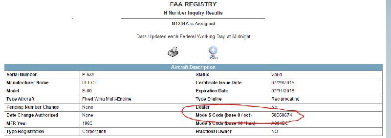

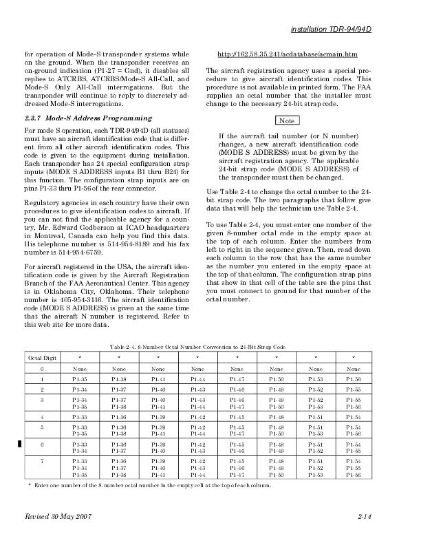

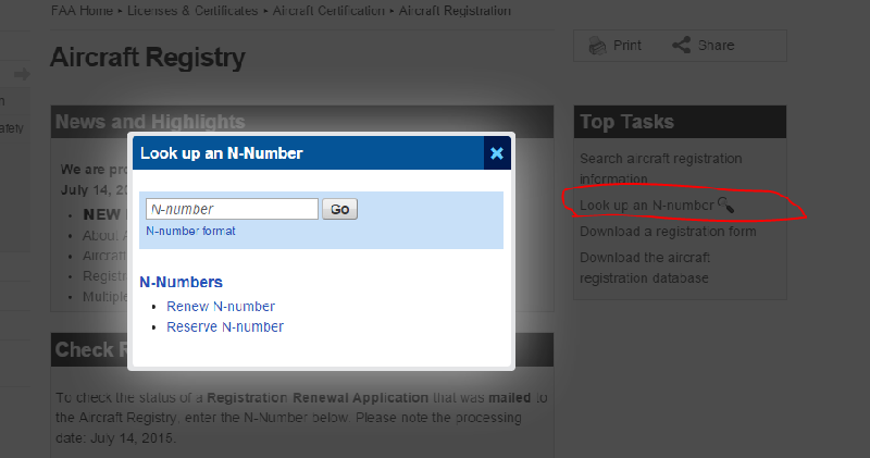

Octal codes for each registration number can be found through this FAA web page . The Mode “S” Code is displayed after the new aircraft registration number is entered. The eight digits are placed in the top row of the chart below to ascertain the correct jumpers.

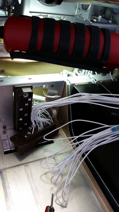

I recently changed the "N" number on another aircraft. This one was a Falcon-50. The transponders are located inside the radome on the top shelf. I was lucky to be able to pull out the strapping bundles for both upper and lower racks (the racks themselves looked to be a bear to remove). There was enough room to manipulate the plugs in such a way to push out and swap the pins. I also got lucky by the fact that the new number required three less pins (which meant no diking/splicing). I applied heat shrink to the unused pins and tucked them back with the bundle for the next guy who changes the number again.

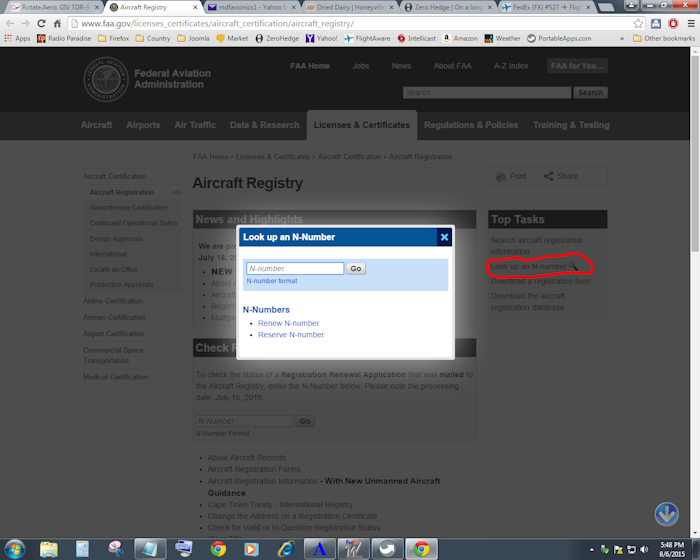

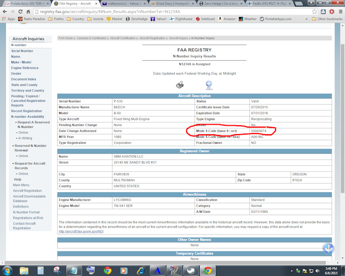

Just a quick couple of images to show the route to go for obtaining octal codes on the FAA web site.

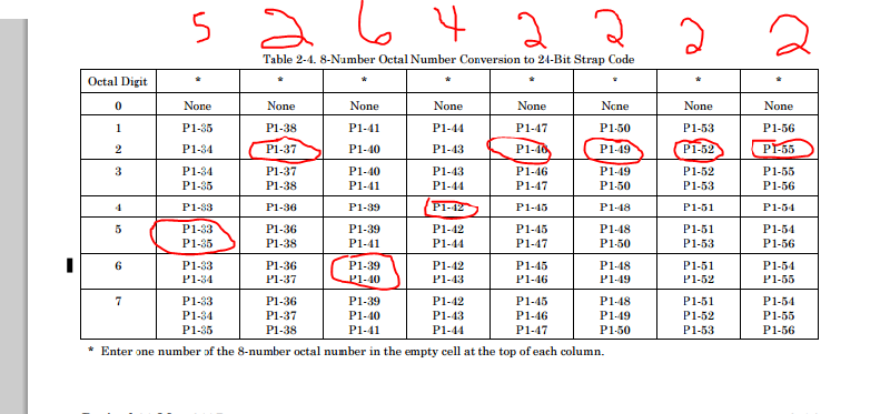

The only document I've ever used for the TDR-94D is
rotate.aero/media/kunena/attachments/936...neIIIM5230772719.pdf
You need two copy's. On one, highlight the pins of the current octal configuration. On the second highlight the pins of the new configuration. Then just compare what pins need to be added or removed for each octal number. You'll find that some pins don't even need to be messed with. Each octal digit will have 0,1,2, or 3 wires hooked up. You just need to compare each of the eight digits across. Some you lose pins (example: only need two instead of three), on other digits you might have to add a pin. ALL the pins connect to ground.

The old "N" number octal is 52642222 which I found here registry.faa.gov/aircraftinquiry/NNum_Re...px?nNumberTxt=n825ms
You'll have to contact the aviation authority in your country for the new octal code.

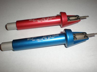

Both transponders use the same code strapping. From the chart, you have a lot of octal codes with only one pin. Hopefully there are some spares tie-wrapped in the back that you can use. If not, you'll need to get some spare pins from somewhere.
Do you have the extraction tool???? You're not doing any change-over without it. And..... make sure the pins lock into place when you insert them, they can be tricky.
(I'm not dyslexic, the numbers drawn in above where done with a computer mouse.)

About the tools, can you give me P/N of it? Insertion and extraction.
For the pins, I reckon, I just look on the P/N on the current pins (if I have extracted one).

There will be no P/N on the pins.
I'll look for part numbers for both the extraction tool and pins tomorrow and get back to you on this post.
