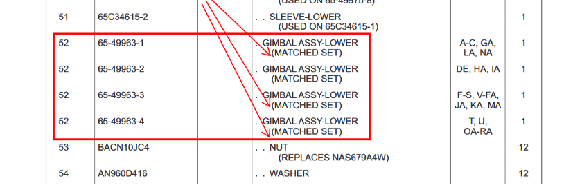

What does "matched set" mean in illustrated part list or component maintenance manual?

Replied by dynamics on topic Matched set
Item 52 of file which I just sent

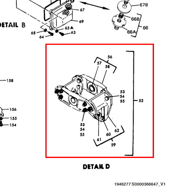

No answer yet, but here's your images.....

My best guess is that these come as a pre-built assembly and they should not have individual parts replaced on the line.
The IPC only shows one installed, so we're not talking two units that must be matched by part number.
