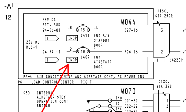

What does "INOP" in rectangle mean in the wiring diagram?

1 year 11 months ago - 1 year 11 months ago #1610 by dynamics
Replied by dynamics on topic WDM-INOP
See attached print.

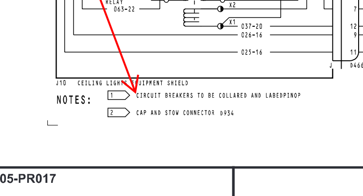

Mark's note: I cannot show a complete Boeing print on the site. I've removed yours and inserted two smaller screenshots.....

1 year 11 months ago #1611 by OG GarlicSalt
Replied by OG GarlicSalt on topic WDM-INOP
Yeah it's disabled inop because C/B collared.

1 year 11 months ago #1614 by OG GarlicSalt
No the C/B are pulled with a permanent collar usually red.

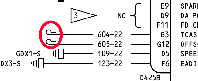

1 year 11 months ago - 1 year 11 months ago #1617 by Mark
Replied by Mark on topic WDM-INOP
The print doesn't ask for it to be capped off. Just the collar.
A capped wire is shown as.....

1 year 11 months ago #1618 by dynamics
Would you mind spelling out why WDM asks for INOP label whereas the wires are not capped off and so the airstair may be serviceable.
1 year 11 months ago #1619 by OG GarlicSalt
With the diagram you have shown the airstairs are deactivated most likley by operator request. Either they aren't using them to costly to maintain or any combination of those to.
Deactivation through pulling the CB and applying permanent collar is much easier(cheaper) for MX and also makes reactivation easier if they decide to go that route.
