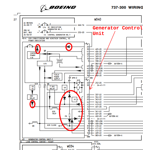

How is diode check of generator control unit done? How can I test a diode while it is still in a circuit without removing it completely from the circuit?

Do you have a diagram, depending on how the circuit is laid out you can still check it. Also I don't know if this is in all cases but bad diodes I have found before have always produced either an open or extremly high resistance.

There is no way I know of to check diodes (or any other components) inside the GCU.
Any component under test must be isolated on at least one side.
Do have an image of what you're concerned with?

Yeah I'm not seeing anyway to test these units without dissasembly of the LRU.

I cannot post a complete page from any Boeing manual.
I've cut an image from your PDF.....
These diodes cannot be checked from the pins on the unit.
