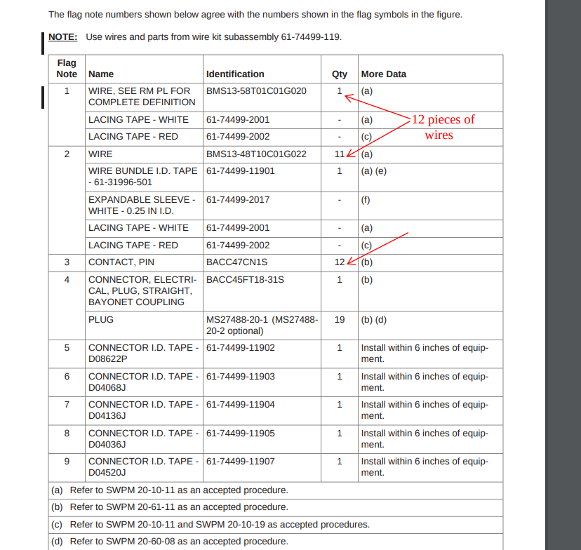

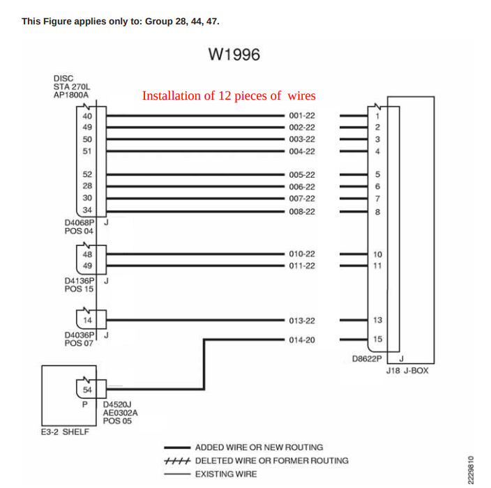

I can not understand why 12 contact pins are used for installation of 12 pieces of wires whereas there are 24 termination points for 12 pieces of wires.

Probably the pins listed are for installation into the rack and the plugs will come with their contacts.

12 wires total. The pins called out are "only" for the plug on the right.
The other side of the wire group goes to different type plugs (which might have different pins).
Those pins must be identified in the Standard Wiring Practices Manual.
I see three jacks and the left and one plug. I know they don't use the same pins.
They could be male or female. Larger or smaller diameter.....
This post:  Pins/Splices/Terminals     Might help you out.

1 year 6 months ago #1714 by dynamics
Replied by dynamics on topic Installation of wires
Do you mean operator should indent for additional 12 pins which are identified per SWPM in addition to 12 pins which are identified in the service bulletin?
1 year 6 months ago #1715 by Mark
Replied by Mark on topic Installation of wires
You have 12 wires with two ends each... 12 more pins are required. I don't know if that's Boeing's job or the individual carrier, but they have to be there to complete the job.
