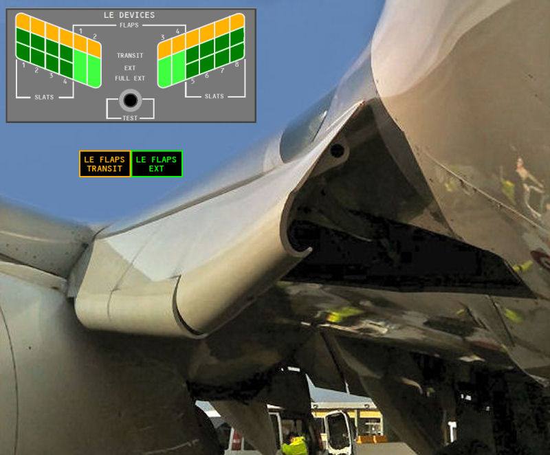

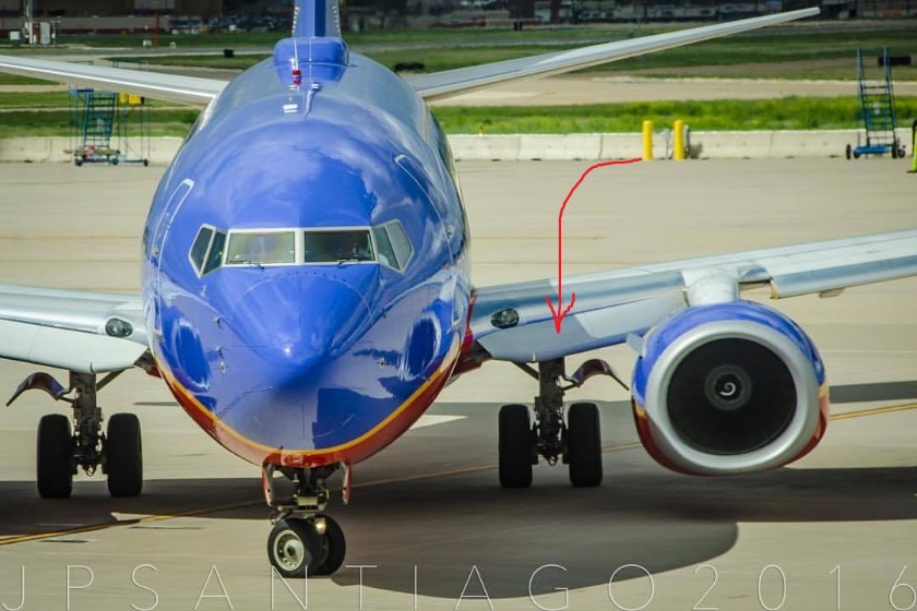

The bussing plugs are mounted to the forward wing spar under the Krueger Flaps.
Those flaps can close quickly and take a person's head off.
Any time someone is working behind the flaps, hydraulics should be locked out. Safety lockouts (if you have them) should also be used.

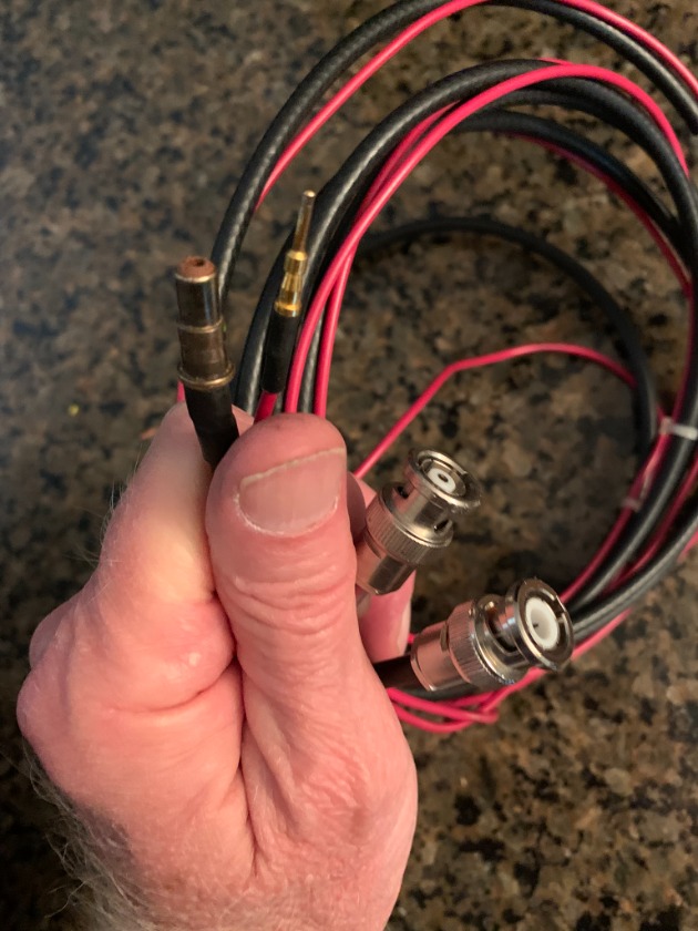

You need a PSD-60 or equivalent fuel quantity test unit. You need the appropriate break-out test cable. You need the test adapter to check individual probes at the bussing plug.

This is the adapter to check individual probes at the removed bussing unit at the wing spar.
