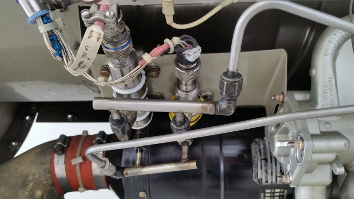

Engine left forward section. Oil Pressure Transmitter on the left and the Oil Differential Pressure Switch on the right.

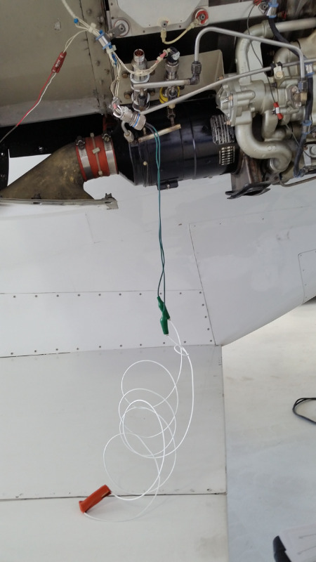

Instead of all this Mickey Mouse crap, it looked like I could use a battery to simulate this voltage. All the indicator wanted to see was a positive and negative DC signal. I wasn't sure if it would work, but I gave it a shot anyway.

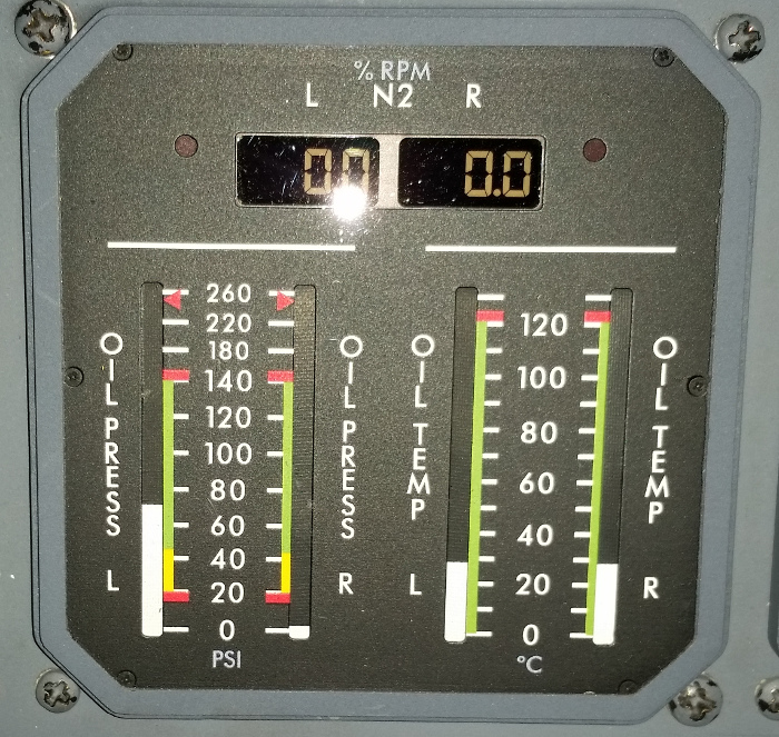

I had this on the indicator (1.5 VDC equalled approximately 75PSI)
This would of been a whole bunch easier with a variable DC power supply or a battery holder pack in which more batteries could be added in to increase the voltage.
