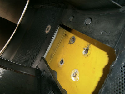

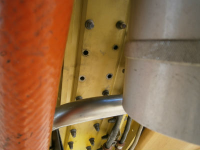

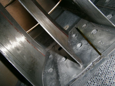

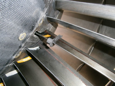

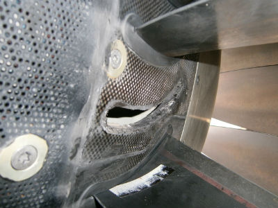

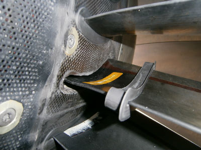

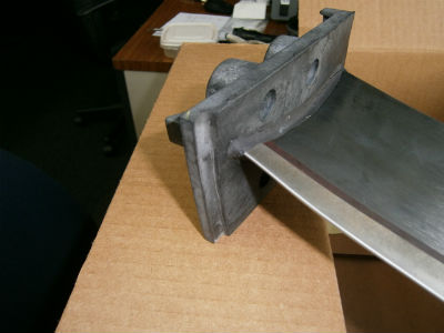

Fixed forward fan outlet guide vane inner seal replacement. Fairly simple job. The maintenance manual has two methods to install/remove vane. One with inner seal in and one out. I recommend seal out. Vane has lip on forward base that has to be inserted first. The top can be wiggled in quite easily with inner seal out. I would think seal "in" would be tougher. (Manual states lube tip end.)
Both inner seal flange and base perimeter use black RTV for final closeout.

Great info! We use this engine in our 747-4, MD11, and 767.
