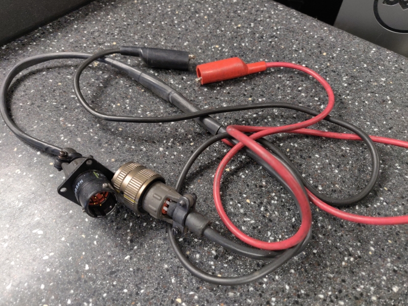

I found out that there was a means of using a break-out test harness right at the sensor during the procedure. With the sensor in one hand and a meter in the other, a null could be accomplished quite quickly.
727's are pretty much gone now, but 757's and 767's (possibly others) use these exact same sensors for elevator and rudder position indication. These sensors are not used in the auto-flight system, but they do require adjustment at times. After referencing some prints, the same pin-outs are used on 75's and 6's.

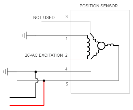

There should be no reason why this harness couldn't be used for adjustment on these newer aircraft types. Two plugs, two alligator clips, and some wire is all that is needed to build one. Pins 4 & 5 are the taps.
The plug part numbers are: Plug (female pins) BACC63BN10-5S (or 48-63N10C5S) Jack (male pins) MS24264R-10B5PN. The back-shells (2 ea) are MS27291-1.
