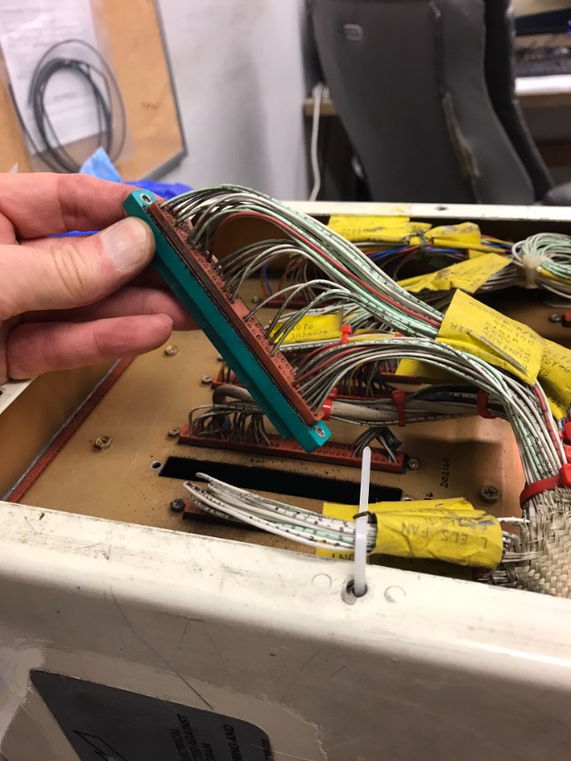

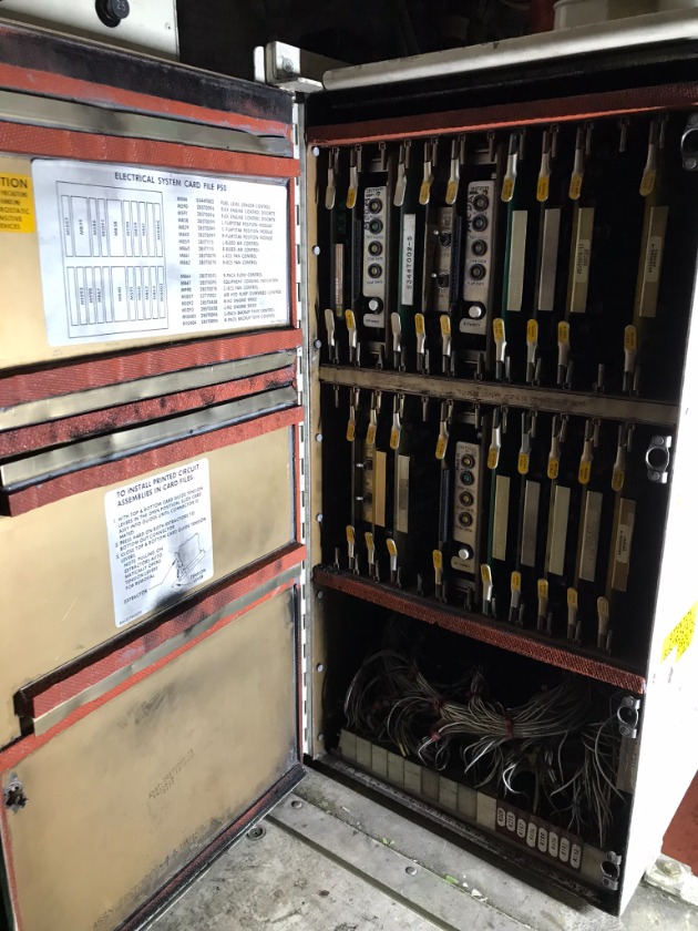

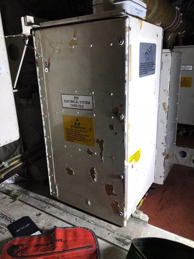

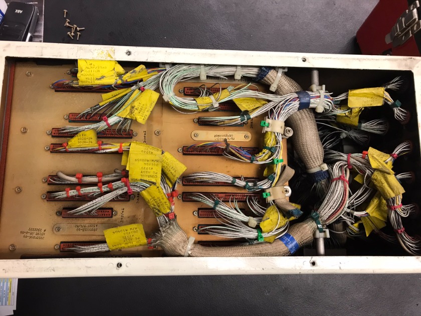

Maintenance Control request to change one of the card connectors in the P50 panel.

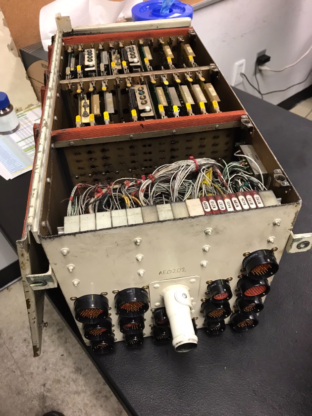

Removed.....
Back cover off.....
Fortunately, the connector slides out the back side.

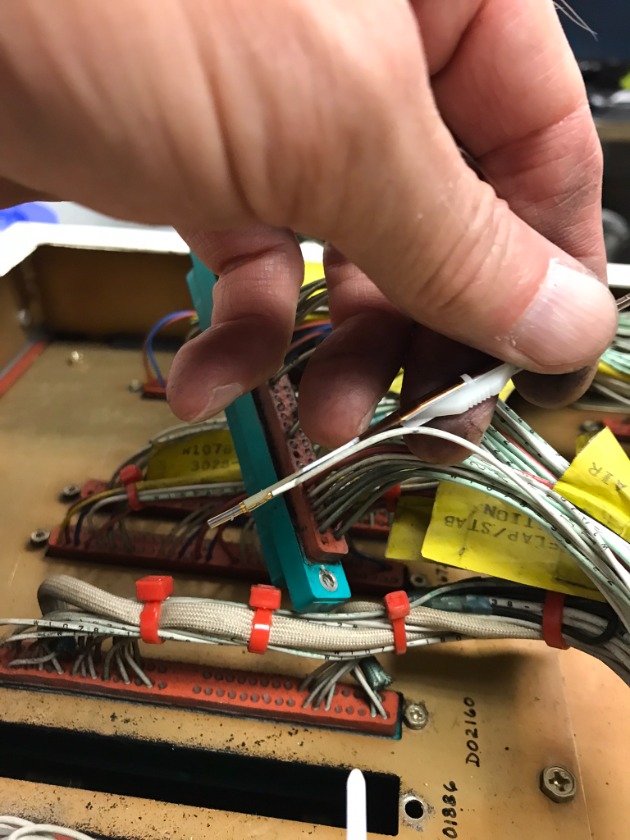

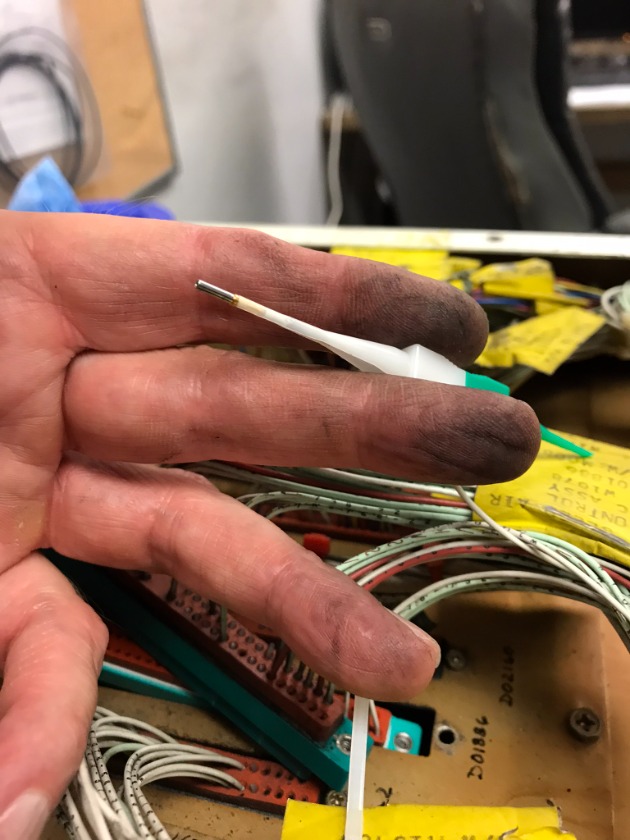

The $120+ dollar tool called out in the Standard Wiring Practices Manual.....
vs. the standard green/white plastic....
(I won't be spending any money on the expensive tool.)
