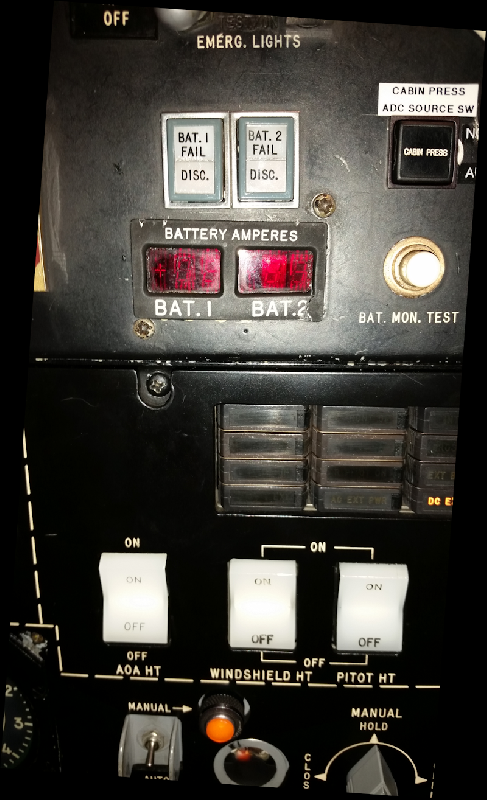

This aircraft had a hard fault for Battery #1. The amperage indication was pretty much stuck on "88" while the the #2 battery was reading correctly.
Overhead Indicator (Poor image.... digits cannot be seen.)

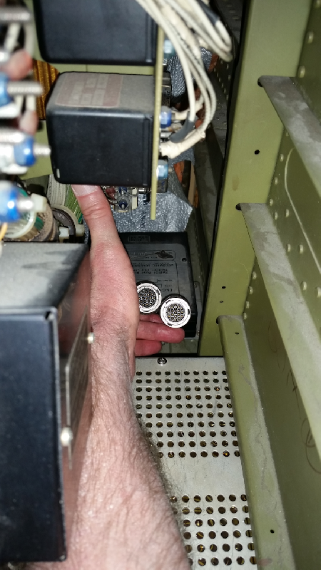

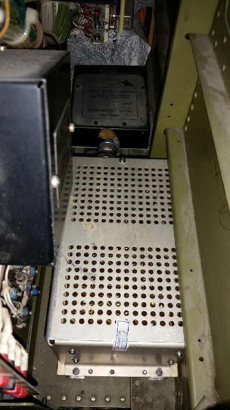

The Battery Warning Amp is located in the 169 panel.
There are two plugs..... unfortunately, they're on the outboard side, but still reachable.
The amp is actually "two" amps in one box. One for each system. The plugs are keyed the same and can be swapped. When they were, the #2 Battery was faulted. An amp was ordered.
