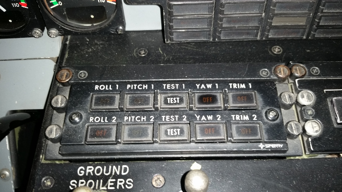

With this particular problem, the crew "should have" realized that they could disconnect the #1 yaw system and continued on with a normal flight. If the auto-pilot is engaged using the #1 system the #1 yaw-damp is running the show. The #2 is ready to take over if there is a failure of the #1 or if the crew selects the #1 off (which they didn't do).
It's as simple as pushing one button on the mode selector. If the "YAW1" button was pushed, the system would drop off-line and a "OFF" would be annunciated on the button.

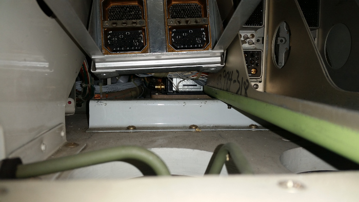

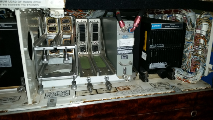

Now...... to the bitch area of this process. GIII outfitters often moved the rate gyro's to accommodate the equipment required by the aircraft operator. The two gyro's (just slightly larger than a cigarette pack) were installed by Gulfstream on the top shelf, aft section. Guess what wasn't there???

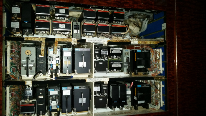

When you're looking at a very busy radio rack, finding the gyro's can be a major issue. Behind the boxes is usually a rat's nest of wires. This aircraft was no different.
After two hours of visually looking, I consulted the outfitter prints (which I should of done first). I was lucky, some operators don't have the prints which can make "any" avionics/electrical job a nightmare.
The gyro's were discovered behind a couple of relay boxes on the bottom shelf. All the operator wanted was to swap the plugs before they would commit to buying a replacement gyro. Even that task was a bitch. A hand could not fit under the raised rack. The plugs could be reached by removing the Auto-Pilot Computer and jamming a hand through a cut-out in the vertical wall.
