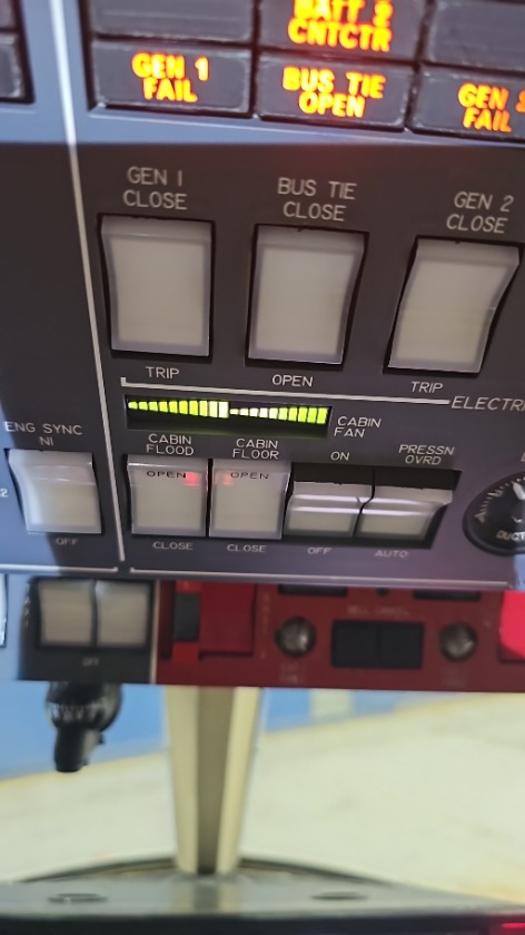

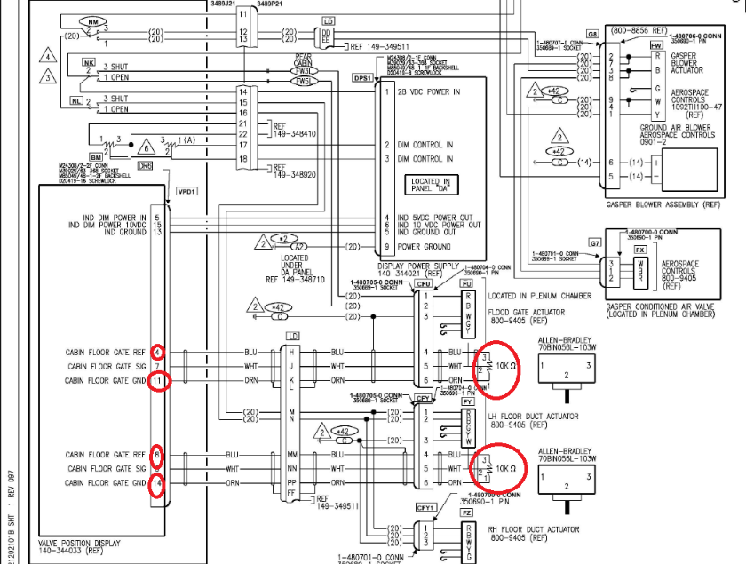

Working on a Hawker 900XP pilot reported cabin flood valve indication always full.

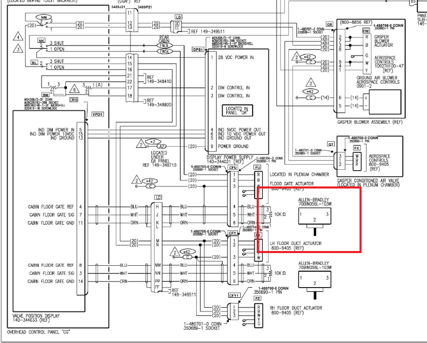

After doing some initial trouble shooting I find that the valve is operating and that the potentiometer that is responsible for the indication is turning with the valve (located behind the aft monuments behind lav sink/closet). After checking this I went into the flight deck to get some readings at the indicator.
Indication on the left non responsive
Once inside i did a few checks

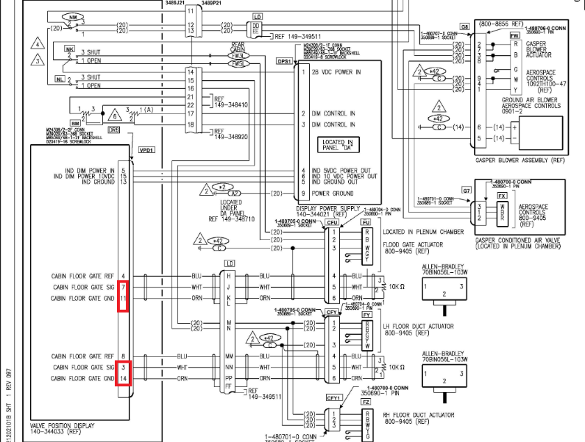

First thing I wanted to check the potentiometer 10k resistor and see what the readings were. I checked both from GND-REF and got about 10K ohms on both.
Next I checked from GND-SNG to see what was the OHMs output as the valve is moving.
I found that the on the working Floor indicator the OHM reading ranged from about 300ohms at valve closed to 5.5k ohms at valve open. I then found on the broken flood indicator that that when the valve was physically in the full closed position im getting a reading of 5k ohms and physically full closed 8k ohms. So seems that we have found our culprit.

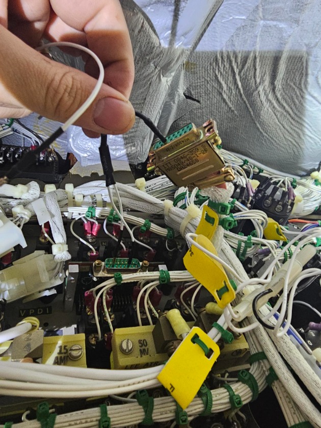

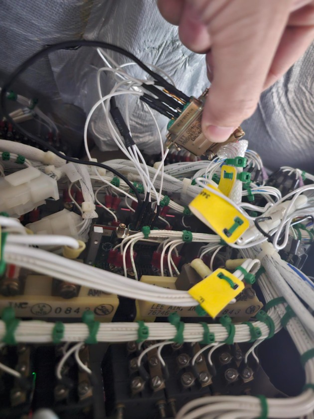

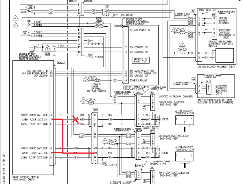

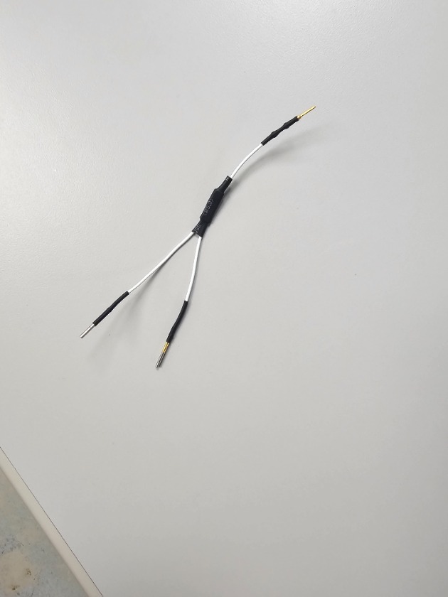

Even though at this point im 95% of the potentiometer being bad i wanted to fully check the indication downstream. So i made a jumper to jump the signal input to both sides of the indicator.
So I hooked up with full jumper set but with the floor valve signal wire going to both sides of the indicator. As i suspected in this setup the indicator was moving on both sides with the floor valve operations. Telling me 100% the potentiometer is the culprit. Also if i didn't have the other floor valve so easily accessible an indicator like this could also be checked with a decade box.
After changing the potentiometer out the indication was good as new.
